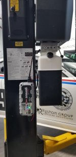

I've had my SPOA10 Shockwave for almost two years now. Not a single issue working the lift. About a week ago, I went to raise the lift, and the solenoid started clicking instead of activating the pump the way it usually does. Sounded like a dead battery situation.
So I removed the access panels from the unit and was planning to measure the voltage of the cells. Before doing so, I pressed the button one more time and BOOM. One of the batteries exploded, releasing gases and sulfuric acid all over.
Fortunately, I was standing on the side of the unit when the battery exploded and still have my eyesight. It sounded like a rifle, it was that loud.
I quickly left the area and opened the external garage door. I then spent 2 hours cleaning up the mess.
I suspect that one of the batteries must have failed and that the charger was not smart enough to stop charging and created an overcharge situation in the good battery. I'm glad I didn't try to remove the battery because it's possible it could have exploded in my face. I was very lucky.
I have replaced the charger that Rotary supplied (a $50 charger that is no longer available from the manufacturer) with a more robust charger.
I also replaced the batteries with DieHard Platinum AGMs.
I would never buy or recommend the Shockwave lift again without confirmation from Rotary that they have identified and resolved the issue. It has been almost two weeks since I have communicated the issue to them and engineering is still looking into it.
So if you have a Shockwave SPOA10, I'd recommend replacing your batteries yearly. Maybe this will save someone from going through this experience.
If buying new, just stick with the non-Shockwave version, which is probably sufficient for most of us. If I could convert mine to 220v, I would.
Here are pics of the battery, their charger, and my new charger setup.

This is a case where the battery had a broken bus bar. It would provide voltage when the two pieces touched and no voltage when they did not. There was a spark when they touched. There was hydrogen from changing the battery and the spark set it off. BANG. Replacing the batteries will not help this. Does not happen often.
E
ewjax
Mar 6, 2015
72
That's great information. So maybe a low quality battery?
Would that better charger pickup on this scenario and stop charging?
Walter_TA
Mar 11, 2017
191
This is usually a handling issue. The bus bar is lead. If the battery is dropped or hit, the bar can break. I have not seen a charger find this issue. If a battery is putting out current and then stops this will likely be the cause, once bad connection are eliminated.

IMHO, The battery experienced catastrophic failure probably because of an internal mechanical failure that produced an ignition source for trapped Hydrogen gas.
Jwallace1
Oct 25, 2018
141
spokane wa
we occationally see batteries explode at work, standby generator applications not a lot of abuse due to the application, they will sit on a battery rack on the floor or mounted to the generator. looking at the picture of the battery is a cheap genaric battery. the problem usually happens when the charger is charging to hard and the battery expells hydrogen gas it can be worse if its in an enclosed space it traps the gas, a lot of the time the batteries are old style flodded lead acid batteries with open vents and as they vent the top of of the batteries can get wet and attract durt and dust, this will create a path for an arch on top the battery and when you hit the switch the battery is sending out a large ammount of curent that can arc between posts and light off the gas, internal failures can also cause this. get some maintenace free batteries these are sealed, AGM, or VRLA and match the correct charger and that should help
thanks
This sounds like what I may have experienced. Thank you for the guidance and information.
I've since installed the AGM Diehards and with the new charger that has clear indications as to status, this won't happen again.
