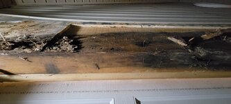

Flashing failed, wrapping failed, rotted the sheathing, rotted the jam. The header jam is stacked 2x4 and not the typical 6x12 Ive seen. The bottom is rotten about 1/4" deep in the middle and the others in the stack are only rotten on outside but have some flaking. How critical is this? can it be DIY or is this an extensive and $$ repair?
I was thinking sand off the junk, mold killer, paint and refinish? Instead of metal flashing going to use some wood siding. After wrapping hit everything with flex seal.
In the pics, right right side of the pic stil has sheathing, left does not. You can see the ragged water line. Dots on garage door is grease from opener jackscrew.

I zoned into the face. You can see the lines where the 2×4 meet. The 2nd pic is looking straight up its a stack of 2x4 unless this is a 4" thick wood...

That looks like a glu-lam beam to me. When you say stacked 2x4’s I thought you meant separate 2x4’s nailed together to form a header. Maybe treat the rot area, flash correctly and cover it with siding

It is not a gable end since we can see the ends of the trusses in one of the pics. I would be somewhat concerned but I am not sure how concerned. Even w/ all the good pictures you have provided it is still a little hard to determine how bad it is. One thing you could do to add strength would be to temporarily remove the track for the garage door opener and add plywood to the area I have outlined in green. I'd use construction adhesive and screws w/ quality 3/4 plywood.

It is a load bearing wall, and that header looks worst in the middle where the bending stress is greatest. That you can drive a screwdriver as far as you can does not inspire confidence. I would replace it, but probably with 2 plies of LVL rather than another glulam because they will be easier to install.
This is a job for pros or at least a very advanced DIYer with some friends willing to help.

As said above its a GLUE LAM header. Just replace it with another Glue Lam or LVL.

That looks like a load supporting header to me. Idk why the builder would rely on flashing alone to protect that to begin with.
I would run the vinyl siding down over it. At this point you most likely also need to replace the wood.

Cut the props about 1/2" long and hammer them in tight so they are holding, recip saw round the header to cut the nails, then get it out, shove another in, nail it all back together and pull the props.

I'd say these days we would get $7-10,000 depending on who reworks the siding. And you would need to hire someone else to remove and reinstall the door. You might find someone to do it for less, but we do a couple of residential beams of one kind or another every month and have a license, GL and WC insurance and know what we are doing.
