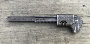

I got this little ford automotive wrench for something like $5 recently. The pin holding the thumb screw in place seems to be peened in, and I haven't quite figured out how to remove it, so I had to leave it together for the cleaning process.
Thing is, even after I cleaned it, the thing runs pretty stiff. The thumb screw tends to stick to the threads when loosening/tightening. I get that its a mass produced thing that probably isn't meant to be overly pleasant to use, but if anyone's found a way to make these things smoother, I'd love to hear!
31,047
Hi Nate. It's made by Moore Drop Forge. I have a few of their auto wrenches in various types and sizes, to include the 12-incher they supplied to Ford for WWII Ford GPW jeeps, and for whatever reason (durability, physical integrity, fewer parts, etc), the dynamic jaws are all permanently pinned. Unlike every other auto wrench I own (e.g., Vlchek, Diamond,.etc), which use a set screw.
You could try soaking it (total immersion) in Simple Green, overnight, then in Evaporust, also overnight, to clear minuscule but hard stubborn gunk and rust. Even if it doesn't look gunky or rusty, it doesn't take much in a few teeth to immobilize them. Followed by excessive lubing. That has done wonders for mine in the past.

Look closely for burrs on the handle and/or thumbscrew, if there are any you may be able to smooth them out with careful use of a small file.

BTW - if you can clean it without taking it apart (like electrolysis) that's how you want to do that. Taking it apart and keeping it as a collectable doesn't work too well...

I have that FORD Monkey wrench in my collection. This Ford wrench and some of the others needed a little attention to improve their function. I have and use an ultrasonic parts cleaner for the freshening up of old tools. I like to use the hot setting and I often place the tool into a ZIP-LOC bag with some solvent, like Varsol. The Zip-Loc bag and contents is placed onto the ultrasonic tank, in the basket. It takes a very little time to get any of the monkey wrenches I have cleaned to move easily.
I have discovered the EVAPORUST performs many times faster with ultrasonic action.
