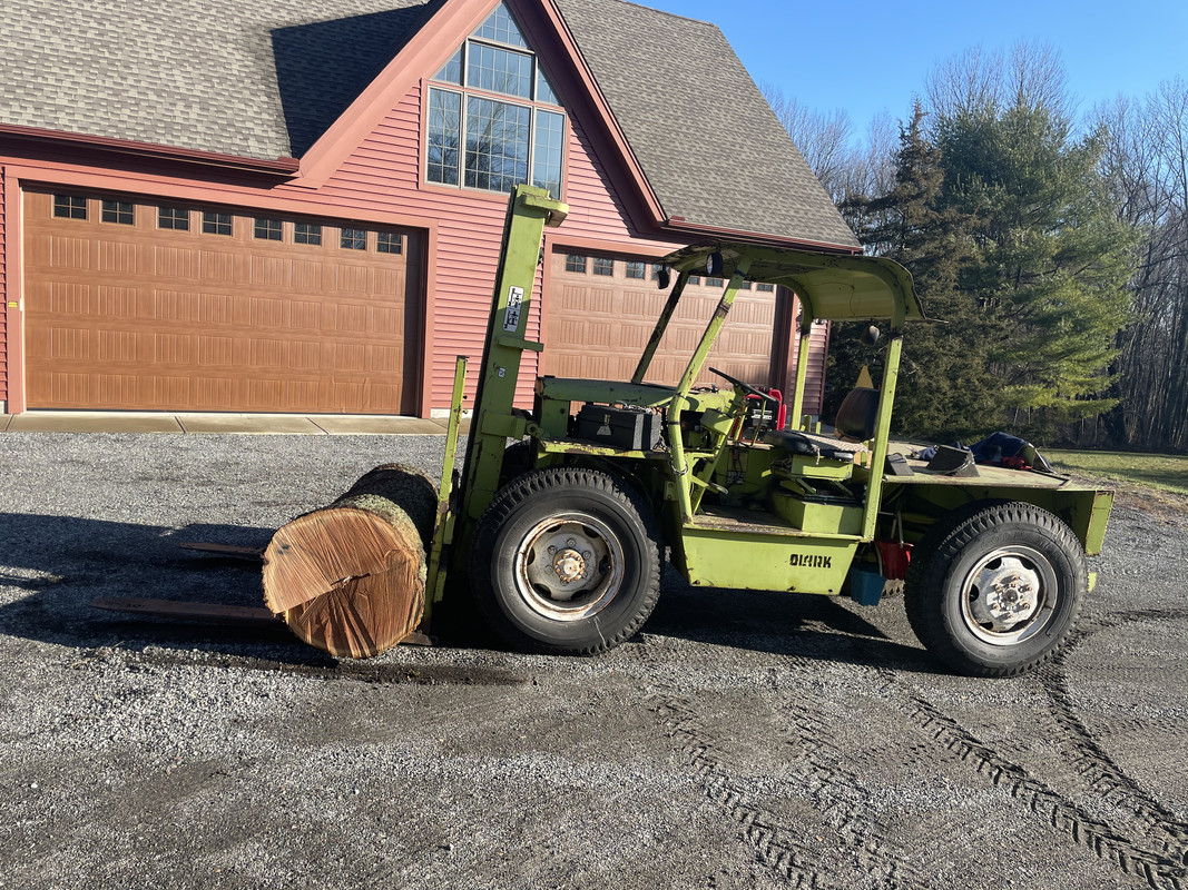

here is my all terrain forklift
actually I needed a tractor for building some fences , digging a pool and moving things in the shop and my company needed an occasional forklift to unload fixtures from a semi , we would rent a forklift at 500 per day now I rent the company my tractor for 300 per day

That's neat. What brand is that? Diesel engine?
Like me I said originally, it is a Clark Ranger 60, gasoline engine, standard transmission, you can select front wheel drive, rear wheel drive, neutral, or four wheel drive. They are out there, but not as common.

Same Clark as strouty
I have kept the split rim road tires on it.
I use it on the dry lawn, trails in the woods getting sawmill stuff etc.
The center articulation is nice to keep things from tipping
I think I was in at for 5k plus a few $ for delivery. At 10yrs of ownership, we are nearly at 500$ a year. Money well spent.

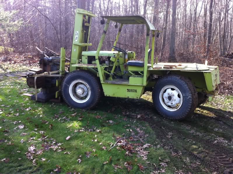

Not me: but about what I am like in the woods!
Lawn was wet in this pic, still not much damage

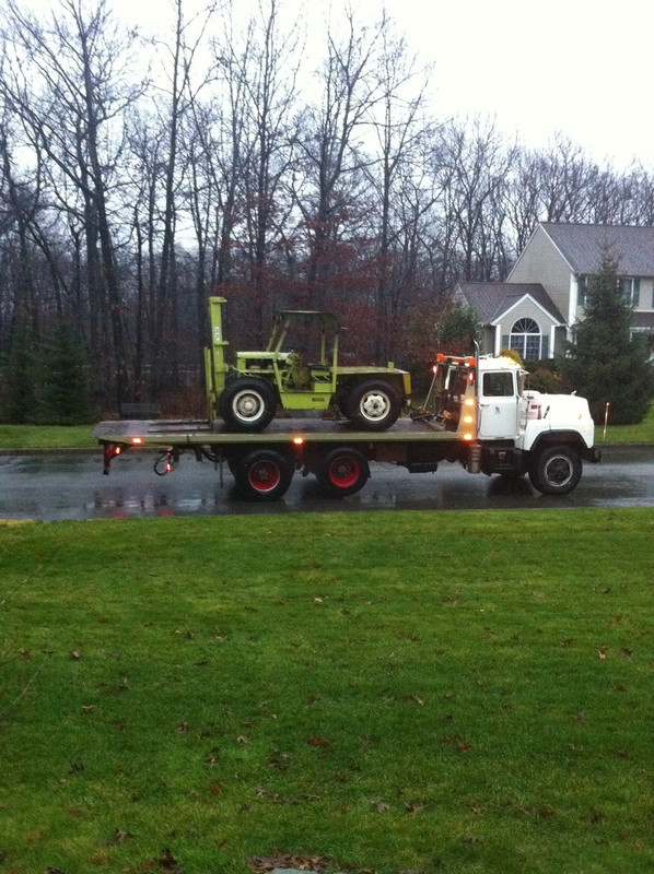

In respect to hauling, mine came out of NH. A company had used it to load heavy.
History of mine:
“A quick bit of the lifts' history for you. It was purchased new by Newman Lumber Company in Woodsville, New Hampshire. When the mill was sold to a Canadian Firm, the owner (Walter Young) kept this particular forklift for his personal use at his home. He had the gas engine rebuilt at that time by a reputable firm - he told me that's why the roof had been cut off and welded back on. I bought it from him and we only used it occasionally to lift heavy loads.”
It was delivered via truck (that I wish I owned!)
