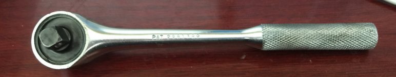

No one has said all RH are bad. My statement, echoed by some other folks, was that, because our first experience with cheap RH ratchets was bad, it's left RH ratchets with a certain stigma for us.
I get it. My first socket set was Taiwanese and cost $2.99 when I acquired it as a 10 y.o. Of course it came with a cheap, round head ratchet. I too had been biased against them ever since.
Recently I've taken an interest in the Kilness patent round head ratchets made by New Britain and sold under many names, including MAC and MATCO.
As member MShaw (who used to work for New Britain in the early 70's) indicated, this design will shear off the anvil before it strips out. Depending on whether the ratchet is a 45-tooth or 60-tooth the locking pawl has either 8 or 12 teeth respectively. With each tooth sharing 1/8 or 1/12 of the load, neither the pawl nor the ratchet head generally strips out. The Kilness patent ratchet design is so strong that both the 3/8" drive and 1/2" drive ratchets use the exact same internals, except for anvil size. If it's strong enough for 1/2" drive ratchets, you can bet it's fine for 3/8", even long handle ratchets.
Attached is my latest find, a CB-45 Husky 45-tooth design. I just cleaned it up, put some Super-Lube in it and it's ready for action again. The Kilness design ratchets have changed the way I think about round heads. Granted, they are a bit more difficult to change direction, but I find that a small price to pay for the strength and small head size. YMMV.
