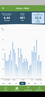

Someone will come along and cite "load calculation". I prefer power monitoring and looking for peak draw over a week or so - I think that's the best way to check.
I have 90A service to a 40x60 shop. 2 AC units (4 tons), run a welder, a plasma (not at the same time), a 1.5hp water pump, a hot tub, refrigerator, stereo, 2 TVs and have had several RVs connected to power at the same time. No issues yet, but I've also got a "solar assist" of up to 30A.
I'd be a little more concerned if you had an EV charger, a hot tub/pool, tankless electric water heater, or heat pump (electrical emergency heat) - but I see none of those listed.
My service main is 320A, but I can tell you that my residence can easily get by with under 100A and I've got electric heat (heat pump) in the house. If I had a 200A main, we'd still be in good shape.
durk_2007
May 31, 2019
58
GB Kansas
I'm running a 100a service with a 60A breaker at the service entrance to my house with a heat pump, air compressor, 120v welder,and other regular house loads I've never had it pop the breaker. The peak average 15min load I've had is 26A this month.
With the loads your talking about will be well below 100A for both buildings.
