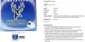

Who has found a good online source of reasonably priced camphor blocks? Lots of it online, but sketchy descriptions for a lot of it. Not available at any drugstore near me.
I spent too much time trying to find a significantly better source than Amazon and ordered these: https://www.amazon.com/dp/B09MMNWS1V?tag=atomicindus08-20 Should be here on Tuesday. And yes, it's hard to compare deals because the descriptions are often unclear.

the description seems pretty clear to me, except doesn't cover the toolbox uses.
Really cool factor in buying this is protects your aura from bad influences and negative energy. Put this in your toolbox and you could hang out on Reddit and Facebook instead of Garage Journal. I bet it's a best seller in California.

For the Goldenrods or other heated dehumidifiers. I didn't connect from the model number that you posted that you were talking about dessicant packs. Camphor blocks apparently work by a different mechanism than desiccants, because I get several years out of one box of camphor for all of my toolboxes. I have no idea how or why it works, but it works.

How about go for zoro and get bonus points for style. Or at least a for conversation starter....

Maybe you try it out first and report back?
Hehehehe ok.
I bet it's a great way to keep people from borrowing your your tools though! No one wants to have to grab a urinal cake to steel your 10mm wrench
