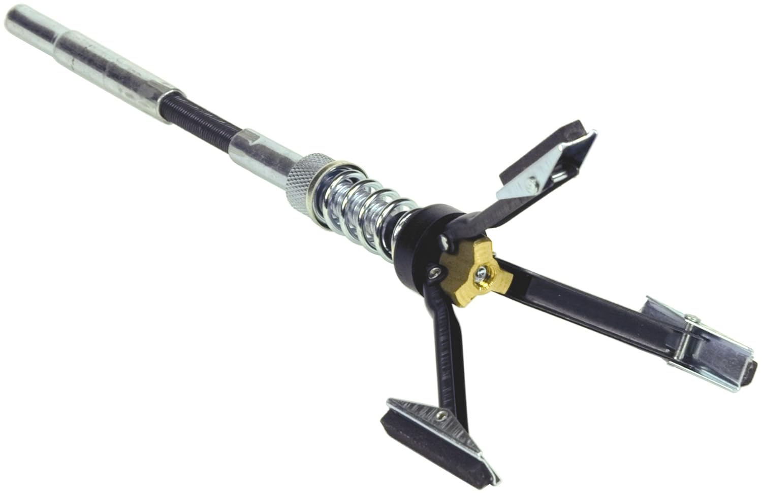

We're talking a 1997 Explorer not a rare or exotic classic car that you can't get parts for. Be safe & buy new calipers.
The bore in the caliper casting is not a critical surface. The seal fits into a groove in the bore and is fixed. The piston slides in the seal and the piston is usually plated to preclude rust. That's why modern calipers are built this way.
To the OP: get a brake hone. Residual pitting on that surface in the bores is not critical. Just be sure the piston slides freely and the OD of the piston is smooth and clean. If the grooves that the seals sit in are in good shape, that's all that matters.

The "DIYer" would also need a hone which adds to the total. And if done incorrectly they can really mess things up, or not even actually rebuild the caliper properly.
depending on the condition, many times you don't and if you do, it's about ten bucks for a new hone

Now, to the OP's original question. When I rebuild calipers I hone the cylinder with a brake cylinder hone using bake fluid and hand finish with an emery cloth/brake fluid to remove any rust and smooth out pitting that the piston(s) can catch on. Then I check the cylinder with a clean piston to make sure there are no hangups. Once I'm happy with the way everything is moving in the bore I use brake cylinder assembly lube on everything and slap it together. Once it is together I like to test the caliper with pressure from my air compressor to make sure the piston still slides in and out of the bore properly before I install it on the car and bleed the system just to make sure everything is groovy. Also, if you have the cash, throw some steel braided lines on while you are at it =-)

$10/caliper for seals. $15 for a brake cylinder hone. 30 minutes per caliper to disassemble, clean, and re-assemble (remember, not talking a pro that does dozens of calipers a day, and the new calipers are rust free)
So we're $35 and 1+ hour into labor messing around with some old crusty calipers. When for just $19 more I could get the job done faster for a lot less hassle.
