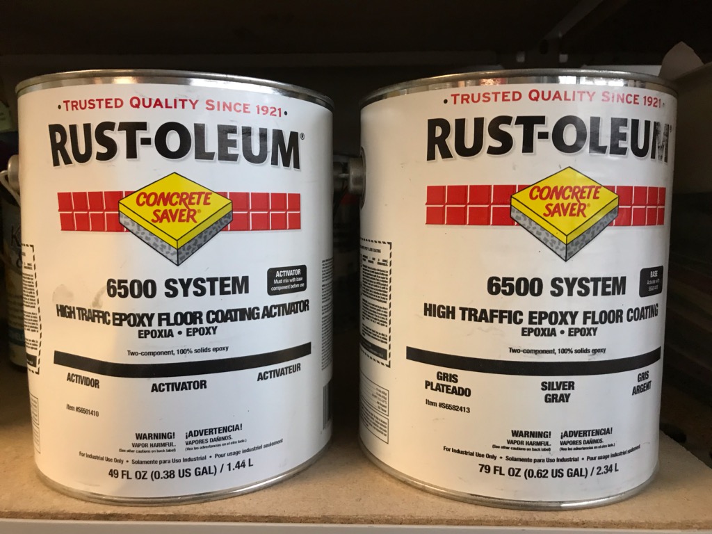

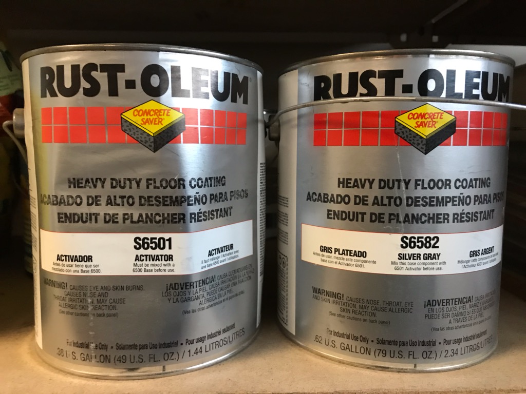

How many cans of the 6500 would you recommend to cover a 24x20 floor? Are the two gallons I have enough? I just had him send me a couple pictures and it seems like they might not be exactly the same but the part numbers look similar (6582).

4 gallons of 100% solids epoxy will get you 11-14 mil coverage for 480 sq ft if you prime, which is highly recommended. If you go much thinner than that with 100% solids it will be more difficult to get even coverage. If you dont prime, the epoxy will not penetrate as well and has a good chance of bubbling on you.
The concrete looks pretty dirty, grinding is always recommended over etching. A lot of cleaning to do.

Really appreciate the info! I'm definitely leaning towards renting a machine to do the grind.
According to the docs I see online for this stuff I'll need to purchase another two gallons as it seems each pair (base/activator) adds up to only 1 gallon (0.65g of base and 0.35g of activator in each can)
