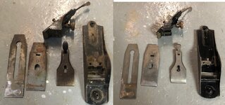

this is what I managed to de-rust w/"my" ph neutral solution, (about 2 qrts worth). before it lost effectiveness (strippers for reference). I will prepare a new batch w/the original slightly acidic formula as I believe the acidity may quicken the results and potentially lengthen the effectiveness (going by original video).
ching0n
Jul 21, 2016
1,496
These parts had flash rust to "above flash rust". I wiped them down before putting them in the solution, ensuring nothing lose was just getting washed off. I can't remember if the wrench had that pattern (parts are dry) or if it's getting dark from the solution. This is after 4 hr soak. The longer pieces were only partially submerged.
I'm attaching my inexpensive "parts list" in case you feel like trying:
My chuck it bucket setup, PH test strip in the background. My solution is PH neutral to slightly basic so more than likely will not attack the steel like the youtuber's in case you forget (youtuber's was mildly acidic so probably would take forever to do any damage too):

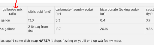

I made 2 gallons of the "original formula". Here's a table in imperial for those that need it. If making this much, mix outside as it produces carbon dioxide which can get dangerous in enclosed spaces. Per video, caustic soda doesn't (??):
citric acid (oz) [and]carbonate (laundry soda) (oz) [or]bicarbonate (baking soda) (oz) [or]caustic soda (oz)(lye)
1 gallon13.35.38.43.9
2.4 gallons2#/32oz bag from link12.720.169.36
also, squirt some dish soap AFTER it stops fizzing or you'll end up w/a foamy mess.

I made 2 gallons of the "original formula". Here's a table in imperial for those that need it. If making this much, mix outside as it produces carbon dioxide and can get dangerous in enclosed spaces. Per video, caustic soda doesn't (??):
gallon/oz mix ratio​
citric acid [and]carbonate (laundry soda) [or]bicarbonate (baking soda) [or]caustic soda (lye)
2.4 gallons2 lb bag from link12.720.169.36
also, squirt some dish soap AFTER it stops fizzling or you'll end up w/a foamy mess.
Y'know, when giving a recipe, sometimes units are handy. Sure, a smart fellow can work from the ratios, but....

I added enough tapwater to cover the static half of the vise which took approximately 10 gallons. To that I added 10 ounces of lye and the rest of the disassembled vise. I lit the propane heater and brought the temperature up until it was just starting to steam and covered it for the night.
The next morning I pulled out the paint free parts with the attached bailing wire and hosed them down. They didn’t need much attention but I wanted an empty tank to keep mixing.
I added 1kg of citric acid which gave me a 1/4 strength mixture and fired up the heat again while putting the parts back in. I didn’t want to pay for enough product to make 10 gallons if it was just going to sit around.
Much to my surprise everything was completely rust free in 6 hours!
