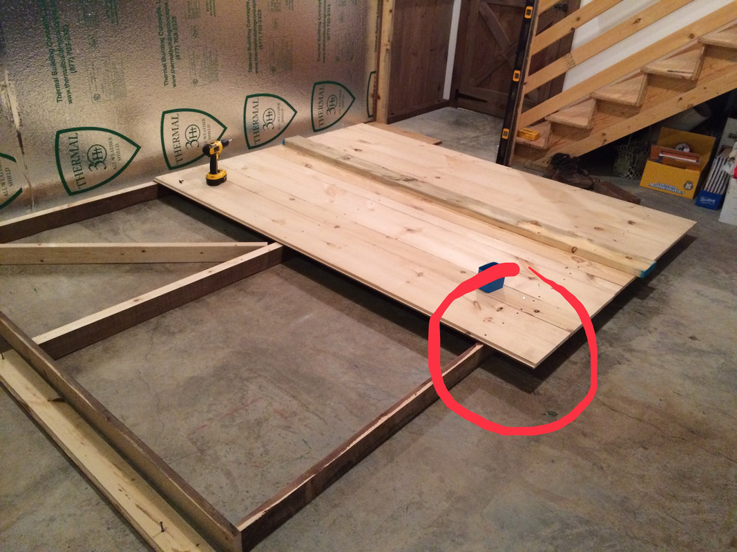

Sorry I didn't get this Friday, I apparently lost some pictures in the shuffle. This pic shows the wall section laying on the floor with the siding boards extending above the piece that will be the bottom of the beam.

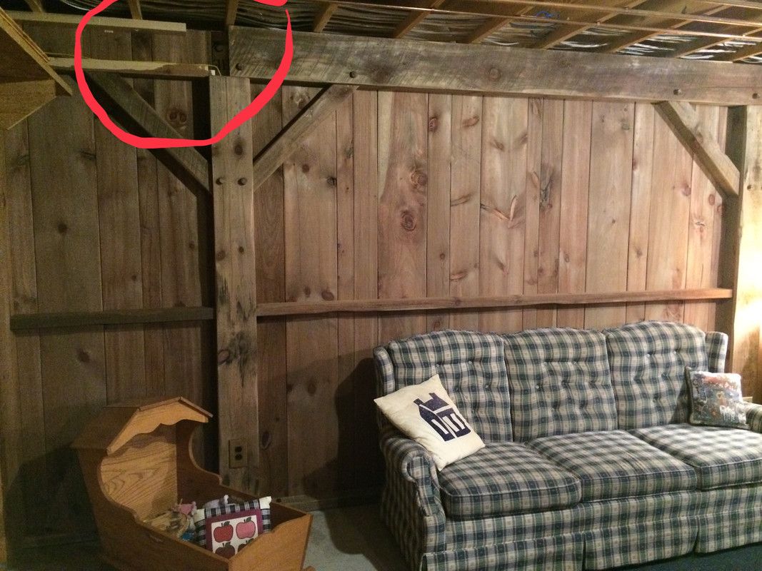

This picture is after the wall section is in place. The 2x4 sandwiches the siding boards against the insulation, and is fastened to the bottom of the floor joists. It also creates a nailer for the top of the beam.
