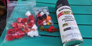

I recently did about 10 cans of Rustoleum, noticed similar thing for white can enamel paint, and don't think they have a quality issue. Notice the paint residue on the used nozzle.
The white can "Stop Rust" enamel is very thick and has a high output nozzel, if you don't wipe clean the nozzle frequently or pointing to the object being painted when you first press the nozzel, there could be problems. The regular "ultra coverage" cans are much thinner and don't seem have such issues.
One thing I'd like to see on Rustoleum cans is better spray patterns. Before painting a file cabinet, I bought some caps from a graffiti "artist" website. The better spray pattern allowed me to avoid "tiger strips" on the flat surfaces. With plenty of new caps on hand, I just used a new cap at each coat.
If clogging is an issue, why not save the used caps just in case you need one. Someone above mentioned "professional" cans. I think they are just larger cans with more paint. The nozzles are probably still the same.
