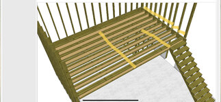

I stumbled upon the forum while searching for garage mezzanine designs. I've read through damn near every mezzanine build thread here which has really helped inform my design and brought to light a lot of issues I had not considered. I recently moved into a house in the Phoenix, AZ area with a large RV Garage. I'm planning on building a mezzanine in the back. I wanted to share what I know about the garage's current construction, my build plans and open it up to the community for criticism/debate/improvement. Here goes:
  • Built in 2019
  • 48L x 21W x 16H
  • Slab is 7.5" thick post tensioned. Concrete spec'd was 3k psi but not sure what was ultimately poured
  • Studs are DF 2x6 @16" OC
My plan is to build the mezzanine in the back of the garage. This area will be used as a man cave type room and will have a sectional couch, bar area, TV, poker table and storage of Christmas decorations and similar items. Dimensions will be 21W x 12'6"D with 7 1/2" clearance to the roof. My plan is to attach an 11 7/8" x 1.75" LVL ledger along the right, back and left walls using GRK or Simpson structural screws. In addition to the structural screws the ledger will be supported every 4' by 2x4 studs laid flat against the wall and secured to the existing wall studs with structural screws. I want to use 11/78 x 3 1/2" TJI joists to span the entire 21' distance (Boise Cascade BCI 90 2.0). The rest of the garage is used as a strength training facility and I need to preserve as much floor space as possible. There will be a small 5' x 5' bathroom in the back right corner that already has the plumbing roughed in. The stairs will be attached to the outermost TJI on the right side. Flooring will be 23/32" OSB screwed to the joists. I'm looking for any feedback/criticism of this design and suggestions for things to change if needed. Here are some Sketchup renderings for visuals:

I was thinking of adding blocking at the midpoint of the span. I'm also going to beef up the area where the stairs attach. Probably rip down a piece of 2x10 and put it between the top and bottom plates. I'll add some blocking directly behind that too.
I know gluing is recommended but if I ever decide to remove this for some reason in the future it's going to make that a lot harder if I want to salvage any of the lumber.
Does anyone have an issue with the use of the ledger boards and the studs underneath as a support system? I thought of framing out a stud wall underneath but would prefer not to do that. I've seen attachment requirements from both Simpson and Mitek on their websites when using their respective structural screws but I haven't found anything in the IRC about ledger attachments to studs although maybe I missed it somewhere.

I wouldn't hang a ledger off the studs for that span without confirming they can handle the load, and checking the 2x dimension you need. Just to make the thing more stable I'd probably frame a wall under it. Or maybe post it with 4x4's. I did that with a mezzanine and then wrapped them in drywall for a finished look.
dcg9381
Jun 20, 2018
11,970
Austin, TX
I wouldn't hang a ledger of the studs for that span without confirming they can handle the load, and checking the 2x dimension you need. Just to make the thing more stable I'd probably frame a wall under it. Or maybe post it with 4x4's. I did that with a mezzanine and then wrapped them in drywall for a finished look.
I'm thinking the same thing. I'd drop 4x4 posts and have the front and rear of the mezzanine done in LVL. It's OK to tie it into existing framing, but I've never seen an LVL connected to a single 2x4, 2x6, 2x8. They are always doubled or tripled up. If you're a steel guy, you can use a much smaller piece of steel as a vertical post and tie it into the LVL with a custom brace. I'd have 4 posts total.
I'd span the floor joists to LVLs, so 90 degrees off of how you have it. All of your load will be on those posts/LVLs, no real load on the existing building.
I'm NOT saying that the type of design you've proposed won't work, it certainly distributes the load across all your vertical framing.. I'd feel more comfortable you can confirm that 18 2x6 at 16oc will carry that. No particular expertise in framing, so take my suggestion for what you paid for it.

I appreciate both responses. My original design incorporated a 5" x 11/78" beam spanning the entire front with a ledger bolted to the back wall and then running TJIs from the ledger to the beam (90 degrees from my current configuration). I was concerned about point loads where the beam ties into the wall with this configuration. I have a third design involving a stud wall at one end which may be the best of both worlds. I'll loose about 35sq.ft. of mezzanine space due to the staircase but it might be a safer structure overall.

There are a number of folks on here that have quick access to the span/load equations, and maybe they'll chime in. Or google could surely point you towards it.

I don't think there is any concern about 2x6 16" oc holding stacked mezzanines let alone just 1. I'd probably treat it like balloon framing, let in a 1x6 into studs, block ends of TJ Is or ok order the ones that come that way, and nail or screw to joists sitting on 1x6. I'd double front edge for wall or railing loads. Assume wall frames to rafters (or truss chord) and would do rail posts also to rafters to prevent rotating TJI.
Rotating framing is ook probably less expensive but a beam 21' is tough at 12", hard to turn up with stairs, and requires columns in wall to support ends. I might go that way with a lot of study, especially probably saving 4" with 2x8 joists.
Don't know if you're pulling a permit but the way you describe lift use, I think code requires stairs to outside and separated from space below. Better to call it storage and after final inspection let it accidentally become man cave. Just a caution.

I with BillConner, I'd sit the end of the beams on top of the 2"x6" wall at each end, you should also block between the beams of use some form of rim board. Taking the weight off the building wall would be they way to go.

I realize I didn't provide the entire visual picture here. In these most recent pics I have rendered only one half the height of the wall. The studs run 16ft. all the way to the ceiling so I don't have a top plate there or a way to bear directly on the studs which is why I was exploring the ledger option. The pictures in my original post are the actual structure of the wall.

Didnt know it was sheet rocked! You called LVL a ledger, but drawings suggest more of a rim joist. One of those varying definition things but I think of a ledger as creating a ledge that something sits on. But you're setting TJIs in hangers fastened to LVL, right?
All that understood, yours is a good plan. Extra materials to not mess with existing sheetrock. All makes sense.
I'm not crazy about appearance of the vertical 2x4s supporting LVLs but agree they are needed especially since attached through drywall. I'd skip LVL on rear wall - just no need - I think I might put a pressure treated 2x4 or 2x6 on edge at base for the vertical 2x4s to see it on, spread load, and prevent decay.
I might space 2x4s closer or even use 2x3s so I could sheet rock walls under and hide the framing. Could do what you say now and add 2x later for drywall also. Just a thought. The exposed framing may not bother you at all.

Yeah I probably could have explained everything better. I plan on using the LVLs as a ledger board i.e. rim joist attached to the stud walls. the TJI joists would be attached to that with the appropriate joist hangers. The ledger/rim joist would be attached to the studs with structural screws and would also be supported by additional studs underneath bearing down on the foundation. And yes, everything is sheetrocked. I was going to remove the sheetrock where I attach the rim joist but I could easily remove all of it and add it back later. I don't mind the exposed framing but I would not want the walls exposed more than necessary.

You could save a good bit of money on this and have just as good a result. For the front edge, two LVLs of suitable dimensions as if you were heading a garage door opening. The manufacturers publish tables for this. Put two studs under each end. Then run the joists short ways in hangers. I'd use 2X8s on 16" centers. I'd also change the depth to 12' even so you can buy 12' 2x8s and waste almost nothing. Blocking in the middle. Ledger at back is just two 2X8s cut to fit. Mark and cut the drywall away neatly and fasten the ledgers directly to the studs. I'd put some nails and then two timber locks through into each stud to hold them up. It'll be stout and not springy to walk on.
I kinda like the bathroom under the stairs arrangement if that's what that space is on your drawing.

i would remove Drywall to attach rim joist - wood to wood Not on top of the drywall.
I would also add 4x blocking between studs, behind the rim joist
double up outside jousts where you attach stairs, block in between top and bottom cord, on the outside doubler ( both joists ) run a set of blocks back to bathroom wall, mid span block the joists - it’s easy with a top flange hanger

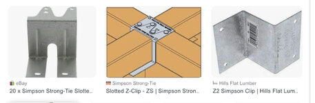

they have a Simpson wood screw lag I would use that to attach the ledger
the mid span block should be in line with your plywood edge layout so you get good nailing on 2 sheets, you can use a Z clip on the top and bottom cord as a mid span block
if the floor feels bouncy add an extra row of blocks
if the stairs feel bouncy add a wall 1/3 to 1/2 up the run, from the floor to bottom of the stringer
NOTE - need to figure out guard / hand rail for the stairs.

Z clip. The only issue w/ mid blocking or using Z clips is it makes the finished floor a little humpy bumpy. But if using a padding and carpet it’s not an issue, if you plan to use a LVP you will have to float / patch the plywood floor to reduce the bump

great suggestions, especially the blocking behind the rim joist. I will incorporate these suggestions.
What do you plant to do on the open end? Full height wall, handrail, wrought iron railing Fence?
This is just a layout of the base framing. I’ll be adding 23/32 OSB for flooring and I’ll build a hand rail for the stairs and a safety rail across the top of the mezzanine.
