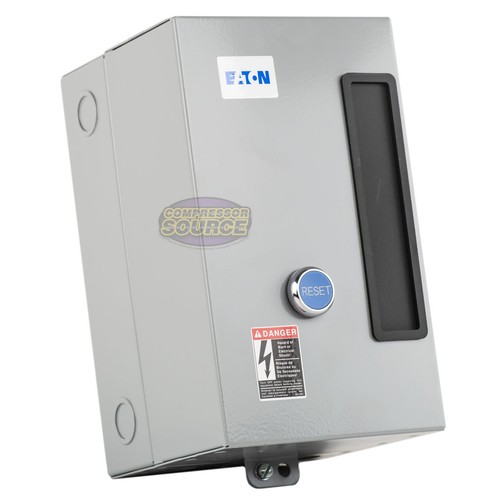

Make sure you run it with a magnetic starter as well if you do get it.

If it is 7.5hp I'd run at least a 40amp breaker, probably 50 is nominal. 30 would be ok for 5hp

7.5hp I don't think will run on a 30A breaker....maybe run, but it probably won't start.
I just lookup up a 7.5hp single phase quincy and the instructions call for an 80A breaker, specifying a 40A draw (running, not starting).

I think he said 5HP on a 30 amp, but no matter its 60 amp for a 5HP single phase

You're going to buy a magnetic starter for it yes?
Jswain
Apr 26, 2013
2,467
Calgary, AB
As long as it's rated for 5hp and the heaters are sized to kick out at your FLA x s.f. of the motor. Looks like s.f. of your motor is 1.0 and Fla is 22amps so no more then 22amps @ cutout pressure.
I like the newer magnetic starters that you adjust with a dial, and if it kicks out you just need to hit a reset vs change a heater, but if it's sized right and you can get heaters they work the same. I bought mine from eBay, Eaton 5hp. You probably have lots of options south of the border though.
This is similar or the same to what I ordered, dunno how the price compares to what you can get elsewhere but for me at the time it was the cheapest.
Model A Fan
Dec 1, 2011
1,224
NW Washington
The one you're showing is for 40A. I'm guessing because of the size motor, I can run this box and 8AWG wire and be safe? I have a roll of 8AWG in black and 6AWG in green for ground I picked up for cheap at Lowes for an eventual project.
I'll be running a separate sub-panel for this compressor and the lights in that room when I get it shimmied into place. Expanding my electrical "grid" has been in my plans for a while.
I'm thinning of using a 60A breaker for the breaker to power the sub-panel this compressor will be wired to. Doors that seem adequate?
30a breaker/wire size to match should be more then enough as it's 22 full load amp motor.
If you think you'll ever upgrade to 7.5hp you may want to size the wire for that though. 8awg will be more then fine for the 5hp motor.
