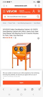

A link might help those that aren't sure of what you are looking at.
Is it red like a whole generation of cheaper blast cabinets ?

The Vevor cabinet looks like the same cabinet every other company sells in that price range. Mine's red, some are blue..

It will probably be the same quality as a HF cabinet.
