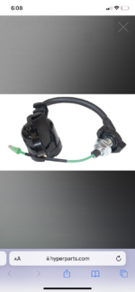

Besides not being a small engine guy, I’m also not an electrical diagnostics guy.
Had to poke around online a bit today - feel free to check my approach.
With the engine flushed and maxed out with oil,
the float on the sensor should be up, not making contact. So, if I put my continuity tester on the wire and the block, I should not have continuity.
The meter just reads 1. If I had continuity, it should read close to zero. Something like .02.
Which, I believe tells me that it is not the low oil sensor.
Whatcha all think?
I also put a tester on the plug , and got no light.
Meaning no juice to the plug.

13,273
not a small engine expert either, but
1 on the meter means open circuit, off scale high resistance, did you test oil sensor when empty for continuity?
I forget how the plug works, but won’t be continuous connection to the plug, it has something that turns it on at the right point in the piston stroke, hoping one of the small engine people step in and tell you how to test that.
Somewhere on that oil sensor circuit are other devices that all ground to kill the engine. Your off switch should also be grounding and ungrounding when you move it, which is why I was focused on it (it’s not a fetish, honest). Other safety equipment like motor guards, blade guards etc should also kill it when removed. (History from a branch shredder, the snorkel sensor wire failed)

When you touch the two leads together on your meter, that shows continuity, when you seperate them that reading shows full resistance.
From the engine block to the wire you want to see full resistance, or, an open circuit.
If it shows continuity when you touch the wire and the block it tells you it is grounding out your ignition. The same theory will apply to the wire in your fuel shut off. I believe most small motors work on this principle, grounding the ignition will kill the motor.
That's the best my brain will allow! Hope it helps.

I tried unplugging the low oil switch, and no change.
I pulled the cover off and checked continuity of the switch and wires of the fuel shut off. All seems good here.
I’m still thinking it’s the coil, so I started looking at it, and decided it’s time to take it to a Kohler Authorized tech. I don’t feel like pulling the whole thing apart to get to it. I need to check, but I’m sure it’s still under warranty.
No point in me voiding it☹️

Had an interesting morning on the Kohler phone tree and website.
Typed in my zip code in the Authorized Service Provider finder.
Got shops all over the West coast(including Canada).
Called the closest ones. One isn’t a shop, and had never sold/serviced Kohler. More interesting was a couple that no longer do warranty work for Kohler, something about never getting paid.
Finally found a shop in Oak Harbor. Had me diagnosed in about 30 seconds. He referred to this little silver box as a trigger switch. If I understand it right, the sensors go through this switch which does the actual grounding.
Per his instructions, I bi-passed it, and the thing started on the first pull!
Kind of an expensive little ******, but I ordered it through him. Might have found it elsewhere cheaper, but he provided great service. I don’t mind paying for that.
