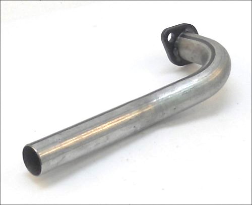

I'm looking for opinions on mufflers. I always wanted a stack out the top with one of those flapper caps (whatever they are called). Well, I have absolutely no room left. This is the stock muffler which I could keep but it's boring.
Or I picked up this muffler and I'd mount it outside the engine compartment. Also, it should keep heat away from some things.
I can't decide. What do you guys think?

If you remove the stock muffler there should be pipe threads in the port that might make the round muffler install easier.

If I may on the muffler/exhaust, if this is going to be used occasionally by you boy perhaps stick with the stock internal muffler as it might be the safer option.
The second muffler looks great, but I'd be worried of it heating up and the lad touching it after getting out/turning the engine off.
You could fit a "dummy" stack and simply fit a counter balanced flapper on it that would flap up and down simple with vibration/movement.

I like the second one, you could even add an extension to raise it up some so it would look like what you see on the big boys... But my question is, does it affect your view at all? You wouldn't want to block your view of the blade or tracks.
As long as you can't decide, here are two more options:
  1. If the sound from the stock muffler is acceptable, B&S makes muffler deflector plates that bolt to the stock muffler (using those 4 threaded holes in the face of the muffler). Not knowing the engine model number, this might not be the right one but it is for an Intek engine:
    This one is available from Amazon ($8.26):
    http://www.amazon.com/BRIGGS-AND-STRATTON-497682-DEFLECTOR-MUFFLER/dp/B002WNVWD2
    Cut off the appropriate piece of mandrel bent exhaust tubing from this J-bend and weld it to the deflector plate. You'd have the vertical stack you're after and no bulky muffler on the side of the dozer.
    This one is available from Summit Racing ($11.00):
    http://www.summitracing.com/parts/sch-016218j/overview/
  2. If you don't like the sound of the stock muffler, B&S sells an exhaust pipe that bolts right to the engine. You might even be able to snake an extension to pass through the hood. Connect the muffler and have the ultimate look you were after. Kinda hard to tell looking at a 2-dimensional photograph.
    This one is also available from Amazon ($12.00):
    http://www.amazon.com/dp/B00437O7EG/?tag=atomicindus08-20
