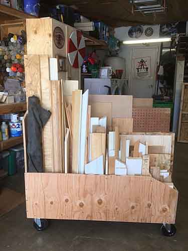

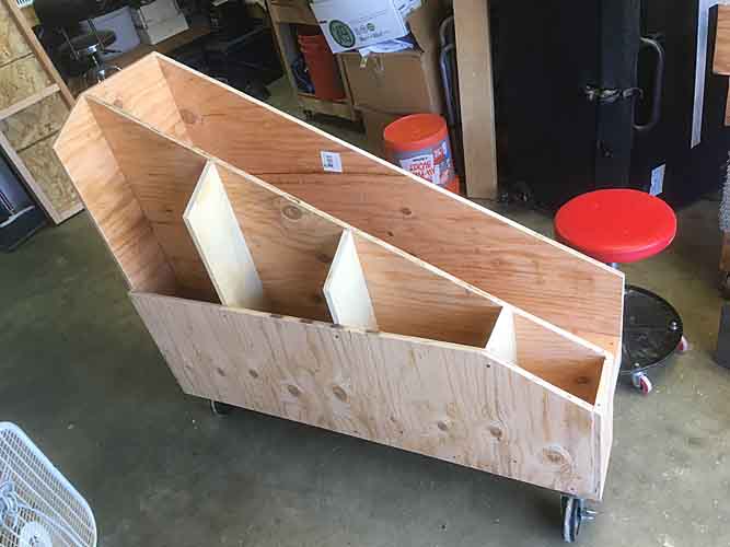

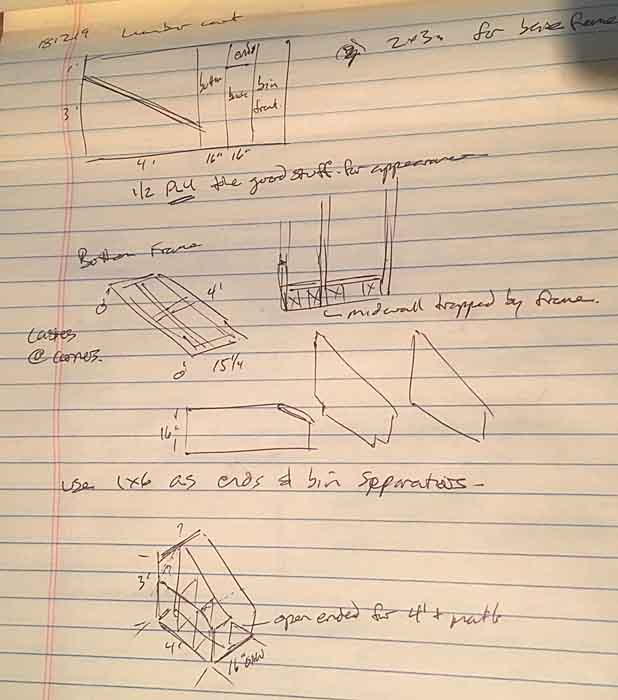

I just recently built a similar small cart for lumber offcuts. It's 4'L x 4'H x 16"W and shape in angles to to create bins from short to long and the diagonal on the large sheet-good area makes it easier to see what is stuck in there, as I arranger the larger / fuller pieces to the back. Maybe a similar layout would work for you.
Man this is brilliant. I’m going to copy/adapt it.

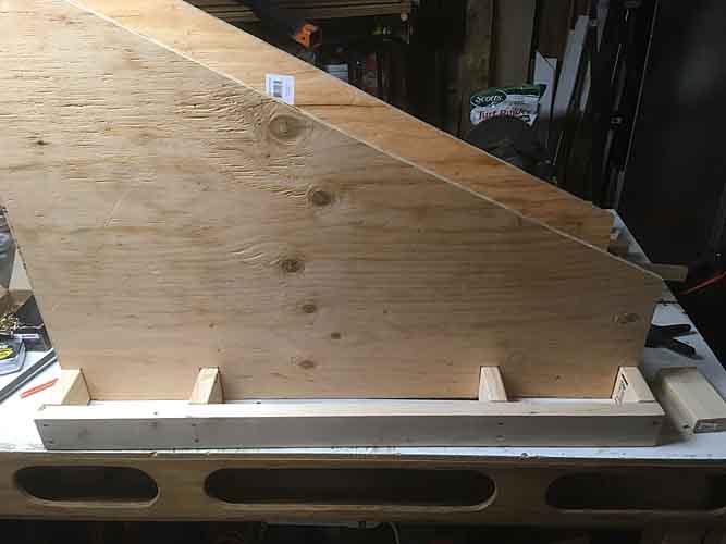

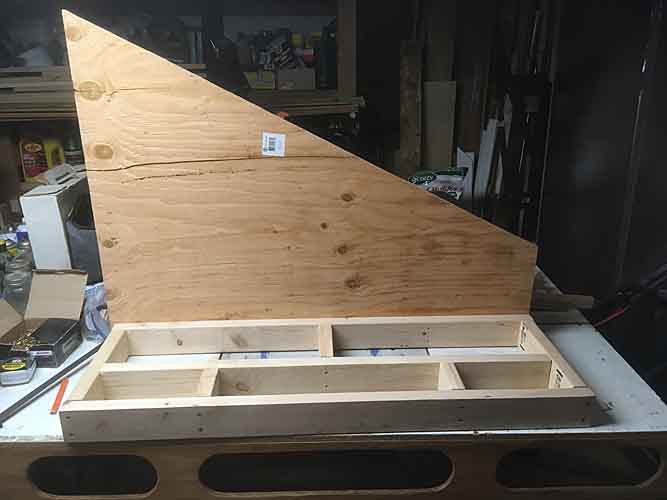

thx for the kind words on my cart idea, it was adapated form several other found online that used a diagonal cut idea. I made it 3'x4' in part to fit a particular spot in my suburban 2-car garage, but also so I could cut the whole thing out of a single sheet of plywood. Just two small narrow pieces on the short end came from my offcut bin.
The big casters were cast-offs from a Harbor Freight mechanics tool cart, which I turned into a welding and woodcutting organizer and put shorter casters on, so it would match the working height of my larger rolling table.
couple other build pics, I used KD 2x3s for the base frame, all three vertical panels penetrate / overlap that framing, so they are sturdy enough to support the shifting weight of all the flat junk stuffed in it.
