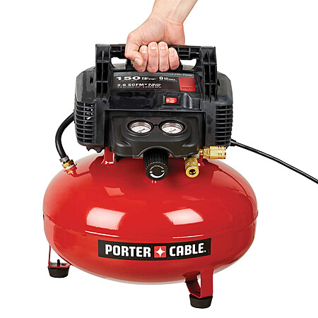

ArcReactorKC
Jun 1, 2019
2,237
Out in the county NE of KCMO
For such basic needs, this
or this
will do the job. Both are noisy. In the past people just kind of accepted that compressors were generally loud to very loud. However, thanks to models made popular by California Air Tools (but not unique to CAT and likely not designed by them either) a lot of "quiet" compressors have hit the market.
They typically use a pump with two oil free cylinders at either end. They are generally much easier to be around (think loudish window AC vs lawnmower). They are also typically lower in peak pressure and have lower flow rate. Both mean you will use up the air in the tank faster and wait longer for it to refill. However, since they are far quieter you just won't care as much. I say this as someone who has an older Emglo 4gallon roofing compressor and a newer CAT 5.5gallon. The Emglo has about 2x the flow but I would rather accept the slower fill rate and not listen to the noise.
Any of these compressors will be sufficient for airing tires, blowing dust off and doing intermittent work with a 1/2" impact driver.
I would suggest getting two different hoses. A 50' 3/8" rubber hose for higher flow and a cheap yellow coil hose (1/4", 50') as they are easy to put away and good for airing tires etc. They aren't good in the cold or for impact wrenches that want high flow.
Yes, bigger is often better with compressors and later you might find you want more. Over the years I convinced my brother he wasn't happy with a 1.5 gallon, then 7 gallon compressor. Now he has an 80 gallon and can't imagine life without. Not everyone falls down that rabbit hole.
That porter cable I was also going to suggest.
I have two of them now, one is used almost every single day running nail guns building sheds. It also has no problem keeping up airing the 34" tires on the F350. For an all around use it's a fantastic value. I don't think it's going to be laying down paint on cars anytime soon but it'll do 90% of all basic homeowner tasks for a great price.
It is also a relatively quiet compressor. It's not as quiet as a larger oiled machine but in this section of the market I always felt like it was a stand out.
ArcReactorKC
Jun 1, 2019
2,237
Quiet, portable. It's become my go-to compressor for tires and my air nailers.
What air nailers are you using? Framing guns? Or brads?
I have been thinking really hard about a cordless compressor for our shed building setup. We can charge batteries in the truck no problem. We are all M18/M12 for cordless but I already run adapters for different platforms.
Senco brad and pin nailers, occasional Hitachi framing nailer; 4 amp hour battery
