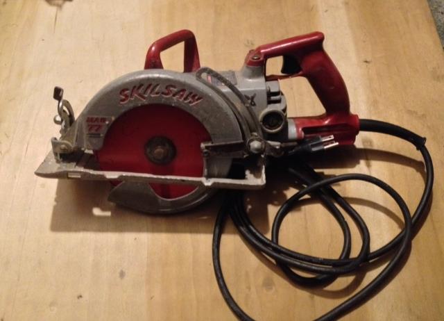

Got me a Skil MAG 77 finally!
$65 from Craigslist! Even has a nifty Diablo blade on it...

I had been looking for a good cheap used 77 for a couple years, and I was at a swap meet and saw an old heavy metal 77 sitting in the $10 each bin. I carried that thing a mile or so back to my car and thought my arm would fall off.
Anyway, got it home and it looked like it had been in a flood - it was packed inside with mud. Took it apart, cleaned it up and it wouldn't work. Needed a new field coil, which I found for $35 on Ebay and some brushes for $12 and replaced the oil and put a new blade on it $10 - so $67 later I have a like new running 30 year old heavy Skill 77. So I'd say $65 for a good running mag saw is a good deal.
Nothing runs like a worm 77 though. My neighbor was letting the smoke out of his cheap sidewinder trying to cut a thick piece for a benchtop for his wife - he was struggling. I pulled out the 77 and it didn't even break a sweat. Probably created some domestic harmony problems with that one....

Great purchase!
That's the older USA version.
I would change the oil first thing, and check the base for square and damage.
It appears to be unabused.
You'll love the power of the saw!
I can start mine up, let go of the trigger and cut thru a 2x4 just from the momentum of the motor and gears.
It really shines cutting LVL's and other dense materials.

Awesome saw! You ****! A pro carpenter buddy of mine was giving me a hand with a deck build at my mom's house, and I got to use his Skil Mag saw a lot. Night and day difference over my Sears Craftsman and my Ryobi saws.
It goes through wood like butter.

Different saws use different oils.
Look up exactly what this one uses.
Change the oil.
No hurry, no shortcut, pay the $12 an ounce if that's the price, order it if you have to.
There are lesser priced alternative oils. You don't change oil in those often enough to need the lesser price.
It's cheap. Skil labels their own 8oz. It can be had for $5-$10.
To the OP, another tip, let the weight of the saw do the cutting. On 2x stock, where possible, I'll lift the edge of the board up and let it slide down or "drop" thru the cut.

Thanks for the advice!
Dumb question - what's the spring-loaded locking/folding "handle" job on the side opposite the blade?
Manual and parts breakdown doesn't seem to detail what this is.

Are you referring to the saw hook to allow hanging off a rafter? Looks like this:
Here is the gear oil you want to use (can be bought at Lowes and Home Depot)

This threads interesting because I've been watching a Skillsaw HD77 for a while in a local pawn. It's been there a while because it's priced at $89 so I'm waiting to see if the price drops. It's an older 13 amp USA made unit in good shape with light wear.
So, what are the differences between the MAG77 and the HD77?

The SHD77M/HD77M is a magnesium body (and other parts?), whereas the SHD77/HD77 is aluminum.
Magnesium is about 1/3 lighter than aluminum.
For my personal use, I don't know that this would matter all that much, but I wanted the magnesium one.
The SHD77M/SHD77 represents the newer 15-amp model, whereas the HD77M/HD77 is the older 13-amp model.
Mine is an HD77M.

What's bent or buggered, exactly? Everything appears straight and true. It certainly doesn't look "new" but everything on it works...
