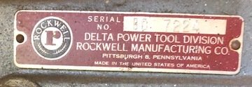

Hey guys, I just scored this old drill press off Facebook Marketplace. I was wondering if anyone could give me some idea of how old it is. Sorry for the terrible cell phone pics. It appears to be in really good shape and complete. The chuck and the quill are tight and smooth. Runs really quiet. My plans are to just clean it up and put it in service. I might get a sheet of steel to resurface the table and put a better switch on it. So tell me what you think. Oh yeah it was $135.IMG_20190423_201524.jpgIMG_20190423_201640.jpgIMG_20190423_201454.jpegIMG_20190423_201505.jpegIMG_20190423_201537.jpegIMG_20190423_201559.jpg
