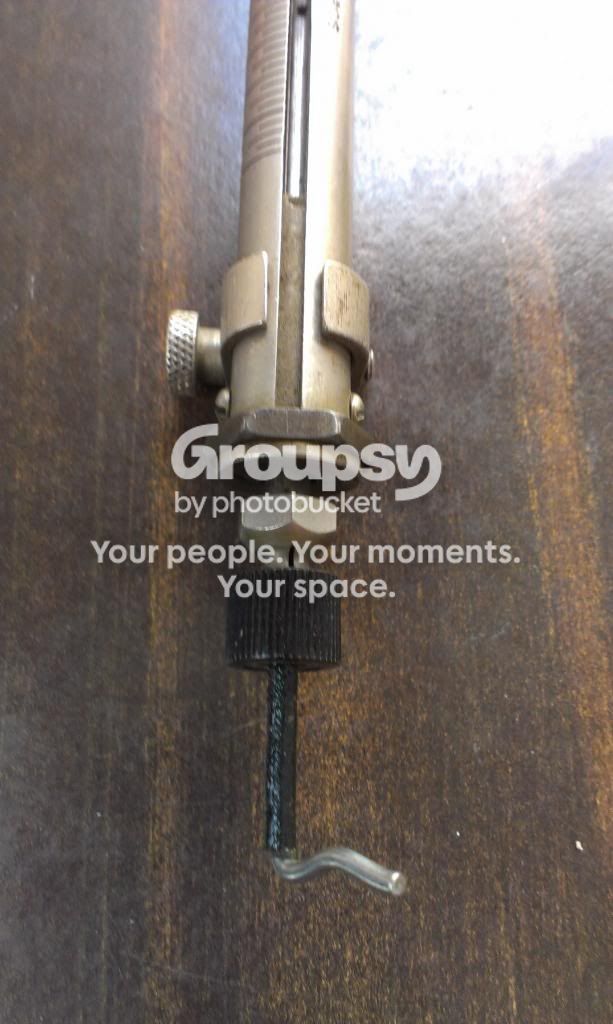

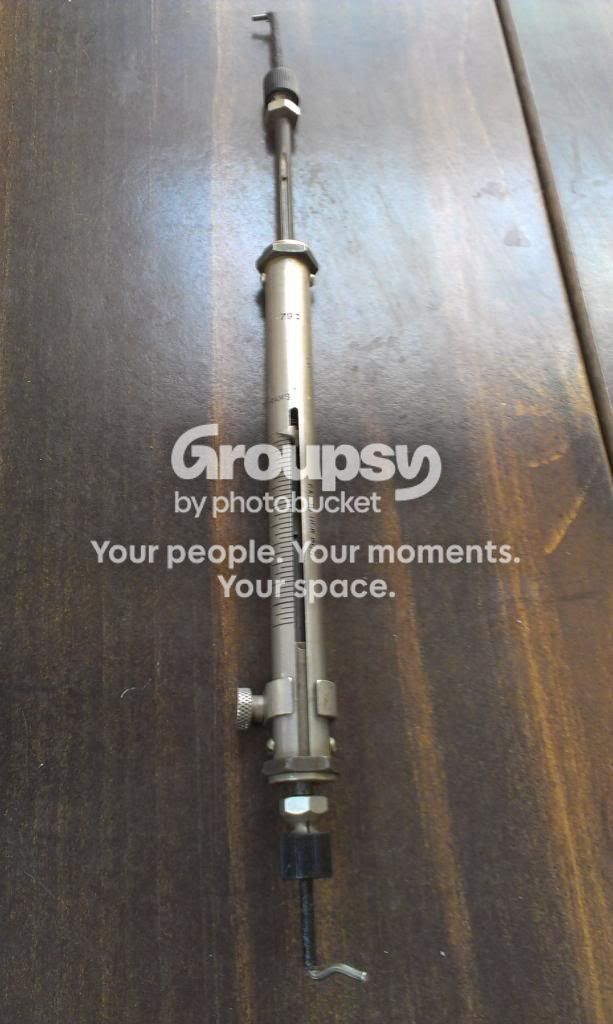

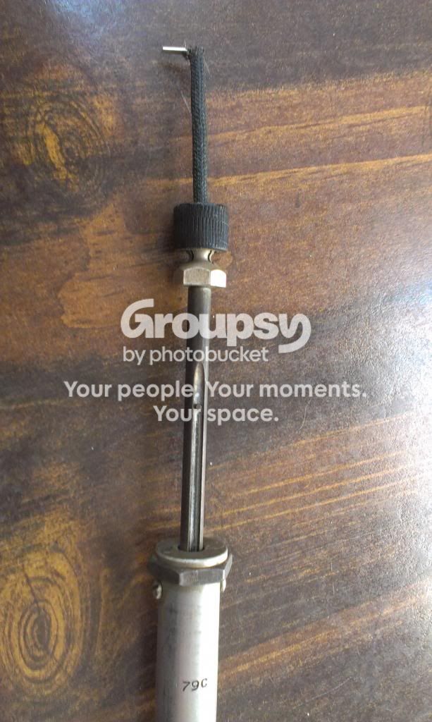

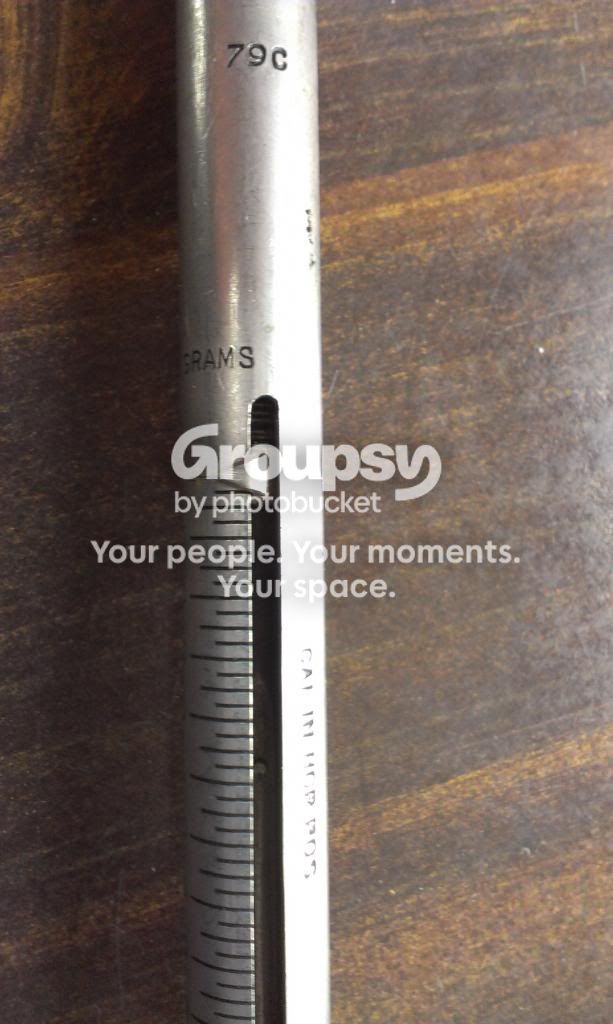

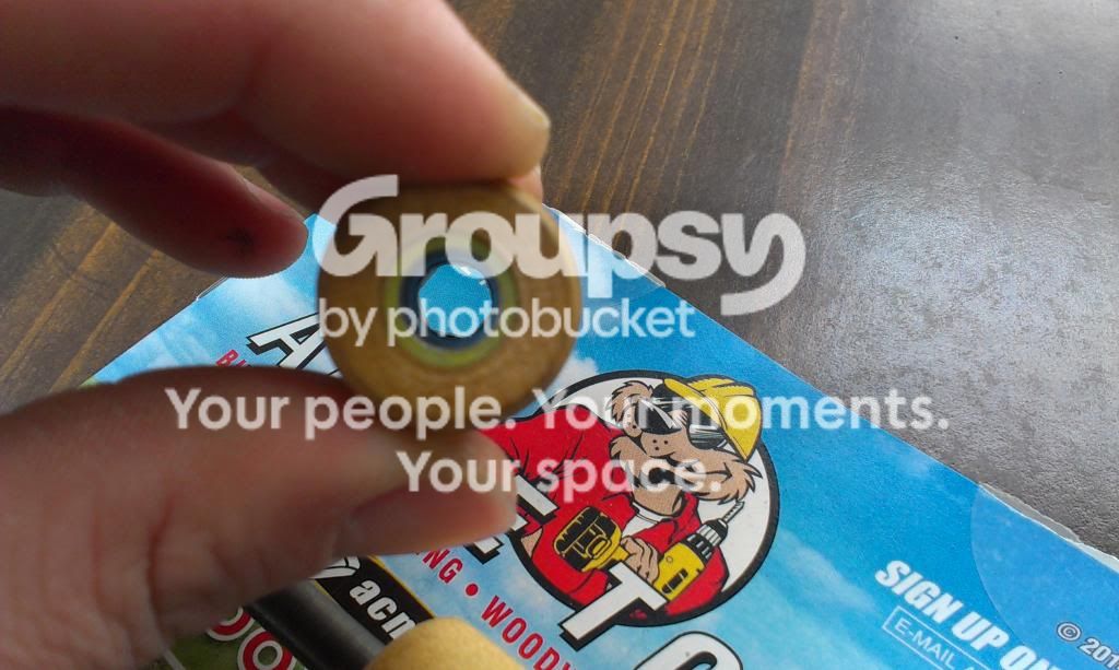

First up is some kind of old scale. Ill be damned if i know how its used or what its used for, but I thought it was cool.

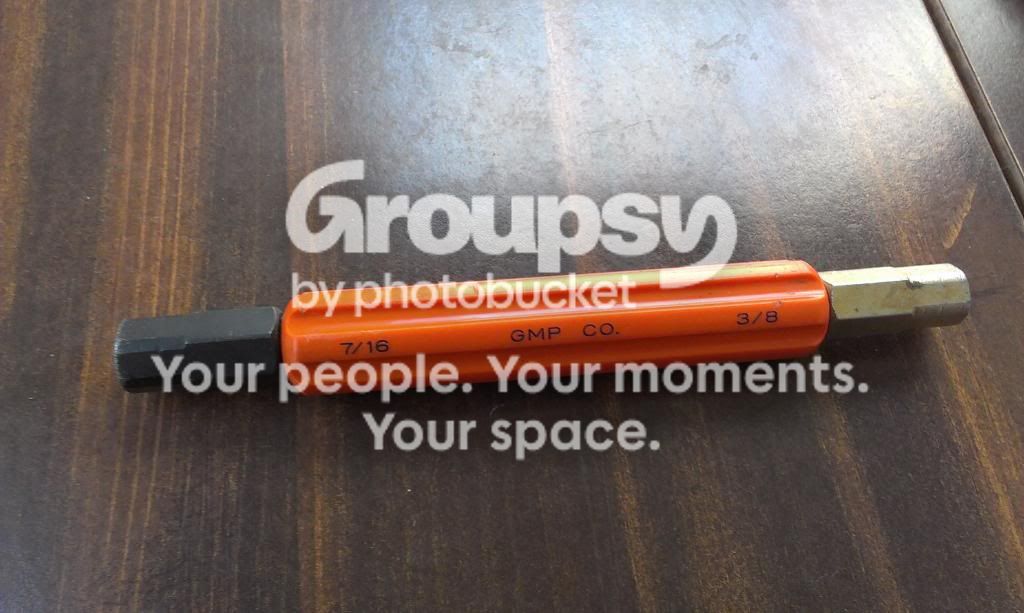

Next up is a GMP Co. Box wrench

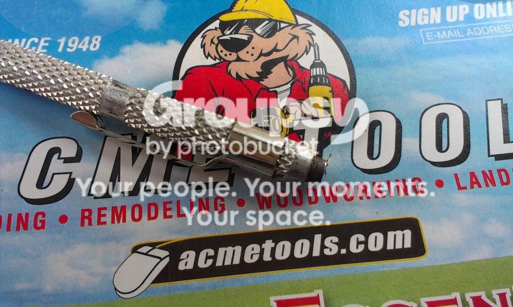

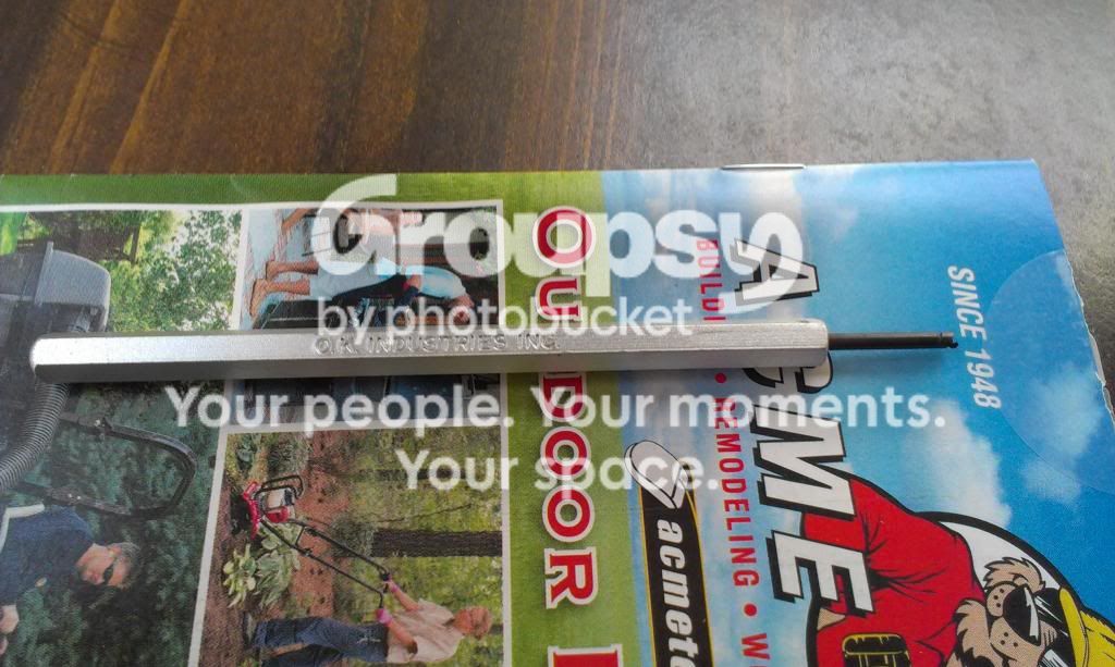

I have no idea what this one was either. It has a magnetic tip on the back side of the funky screwdriver end.

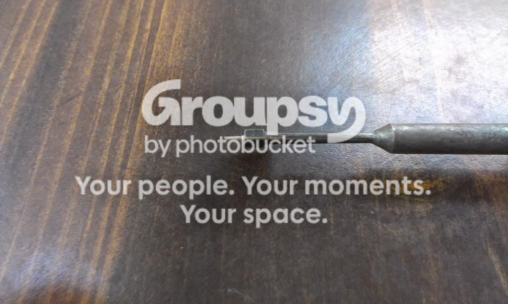

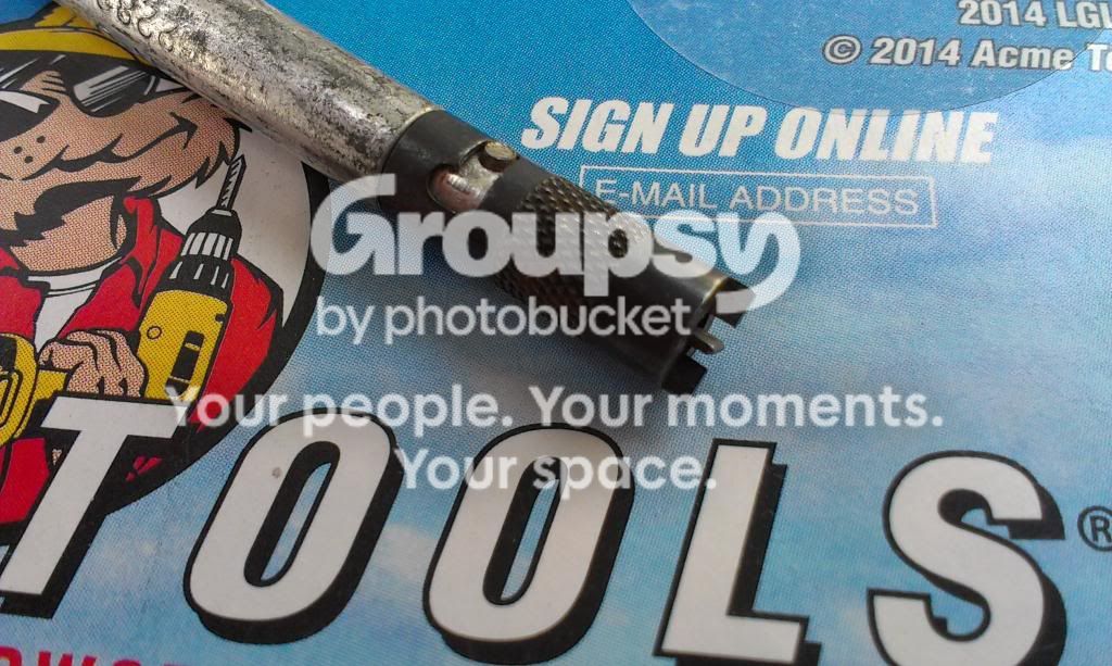

This item I think is used for de-threading wires from terminal.

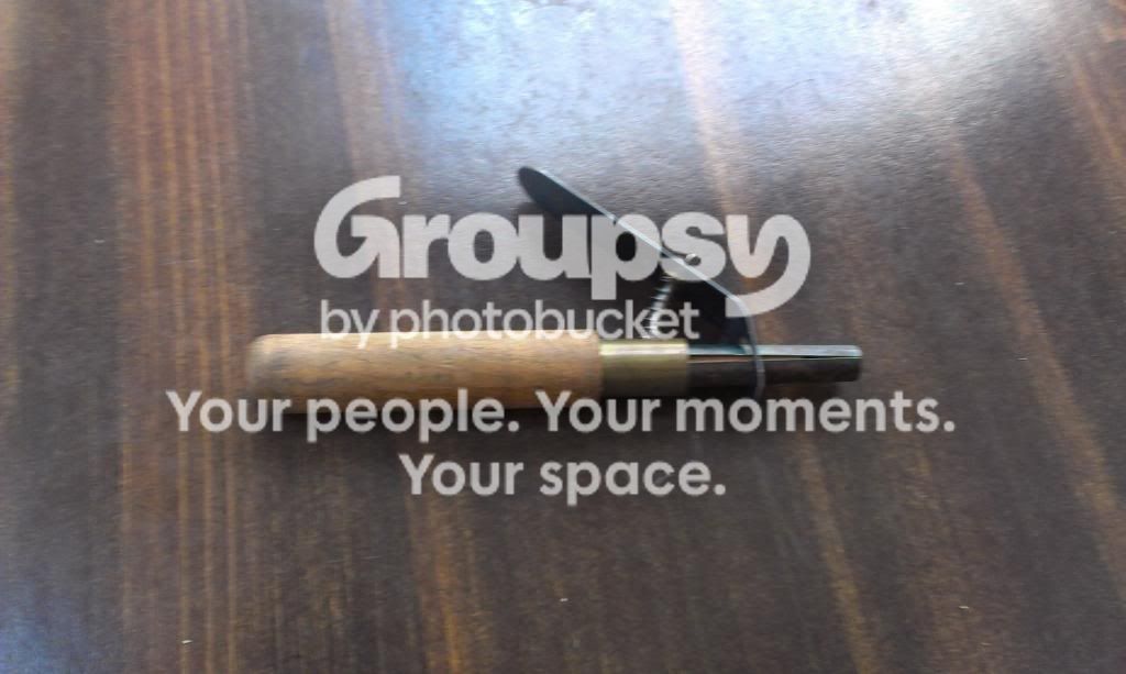

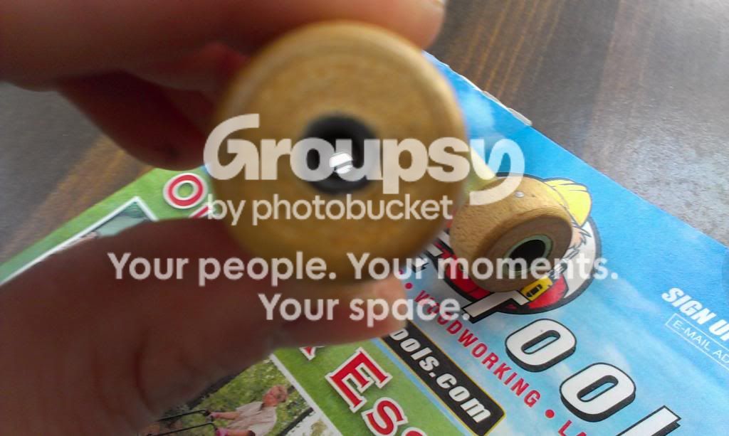

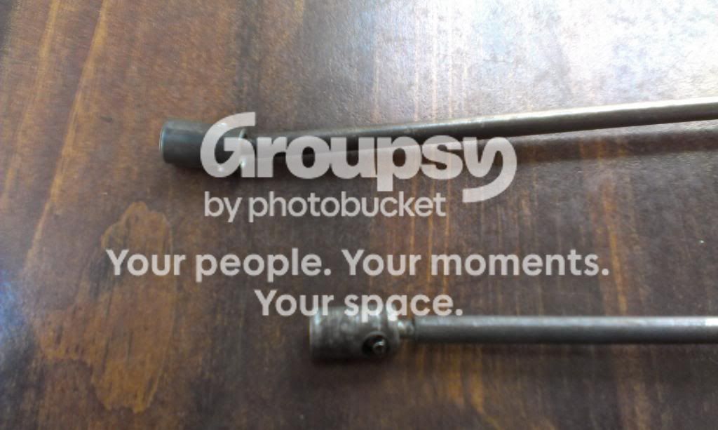

These next two guys are what I believe to be home made.They have cork handles and the stamping is pretty crude looking. I don't know what they are used for but I would assume it is a potentiometer wrench. What ever the case maybe they are cool.

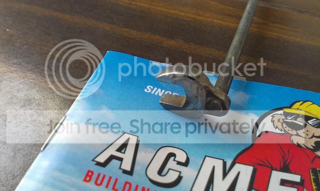

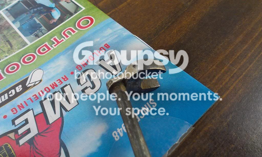

This next one is definitely homemade. It is a crowsfoot screw driver made out of an X1010 Xcelite phillips screwdriver. This one is my favorite tool. I think this is also a potentiometer wrench.

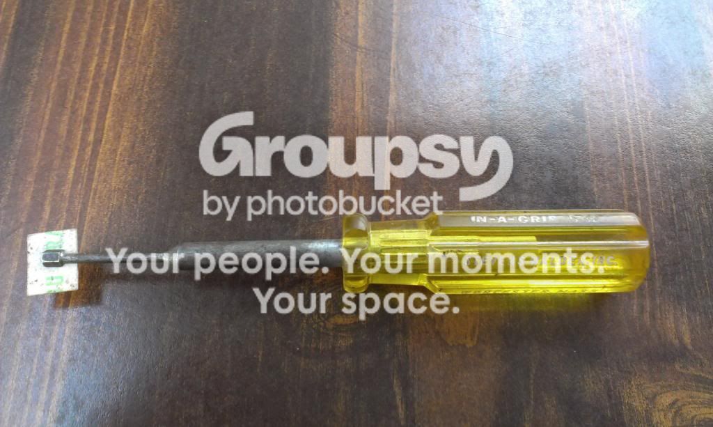

This is a cool old in-a-grip ive never seen one before, I'm sure they are common but it was part of the haul so I'll include the pic.

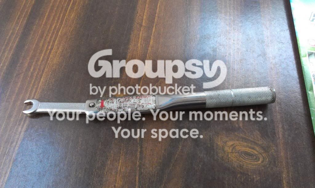

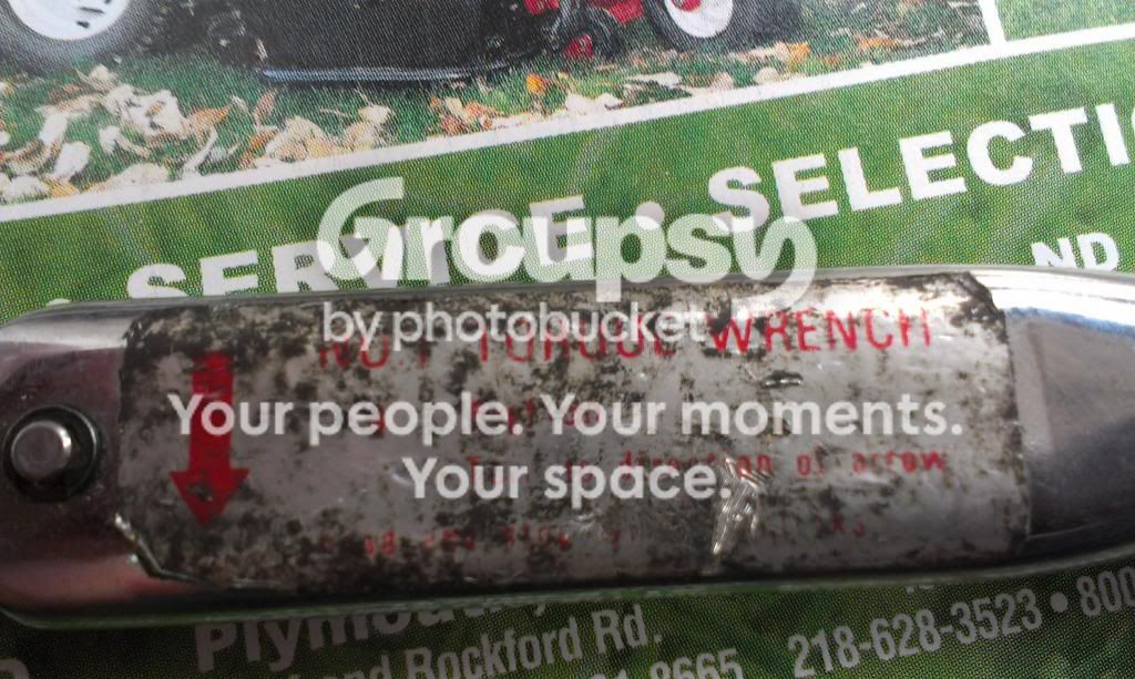

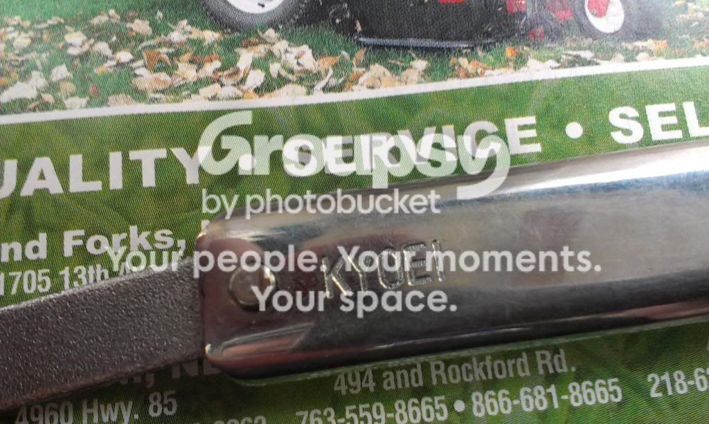

Lastly is a cool torque wrench that I know nothing about but it looks like it was probably used in some manufacturing process.

interesting group of tools you have. i don't know what they most are and are curious to find out. the one that looks like a pen with the magnet on the one end is a flat head screw starter and been a lot of years since i used one, but i think i still have one in my tool box.
I only have quesses on some of the others so will watch and see what others think.

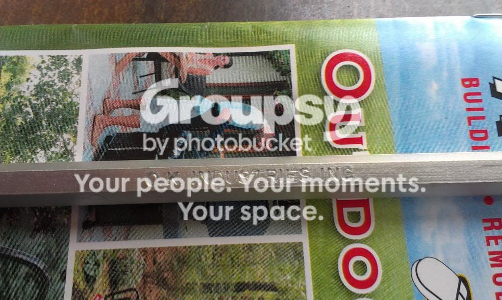

The OK Industries item looks like something for wire-wrap work; either wrapping or unwrapping. I probably still have some like it in my old electronics kit.

The orange wrench is a 216C tool or can wrench, for phone terminals, binding posts, etc.

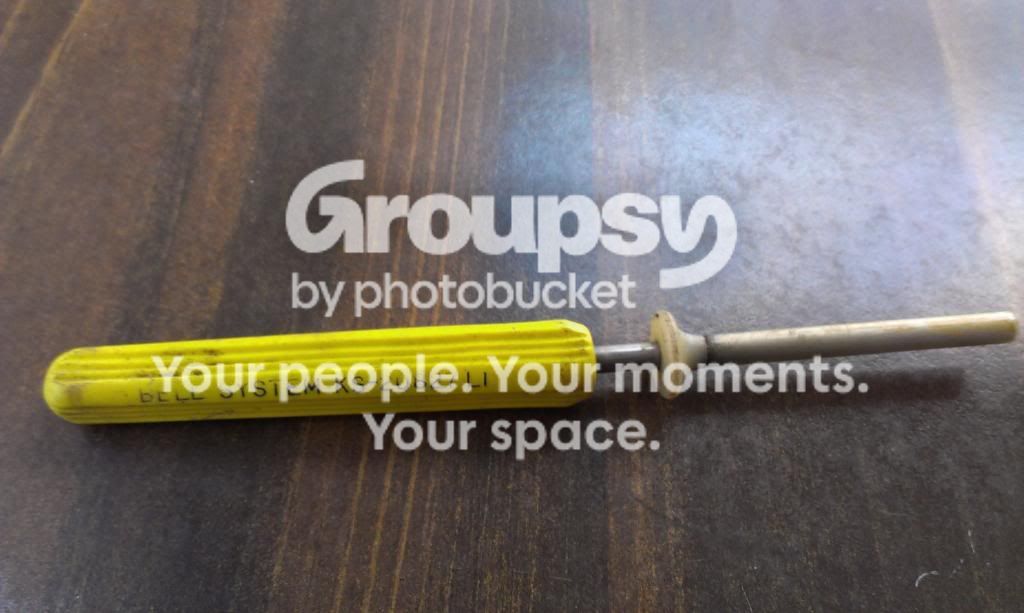

Yellow handled Bell System KS-20827L1 is for wire wrapping

OK Industries tool is for wire wrapping

I have this one by Craftsman. Rotate the black barrel and it spring loads against the slot of a slot head screw. Great for starting the screw in a deep blind hole. If it does not go well, flip it end for end and use the magnet to retrieve.

The magnetic tip silver thingy is a flat head screw starter :thumbup:
Ha you are right tried it out my self.
Yes that was the terminology that I was looking for. Thank you for correcting me.

First picture is a tension gauge.
I think your right on this. My father told me he thought it was a tension gauge but wasn't sure. He couldn't tell me what you would messure tension on with it. That I would still like to know. ?.
This is an awesome explanation for the tool. I don't know why but the sentence "if it does not go well" made me chuckle, like its going to go well. hahaha

Do you have any of the swivel head pot wrench's by chance? Are they pot wrench's? Could you find a reason why someone in the telecom field might need to make a crows foot screwdriver? These are all questions that may or may not keep me up on any given night and would love insight on it.

I have no idea about the pot wrenches. The only thing I could think of that is similar to that crows foot wrench would be a tool for installing BNC connectors in the back of an equipment rack.
http://www.all-spec.com/products/PA1907.html?gclid=CMjNtqGCwr0CFcU-Mgod2XYAlg
Some of the old Bell System kits for adjusting relays (I see them on ebay) have all kinds of specialized gadgetry.
Edit, doing a search for KYOEI wrench brings up information about torque wrenches. Perhaps it's for 7/16 cable connectors?
Correct. That is an unwrap tool for removing connections from a ww terminal. Was used for telephone and then became a common means of building circuits for electronics without having to do a PCB.

The torque wrench looks a lot like some I saw at a tractor manufacturer's plant last fall. I didn't see what brand they were, but the most common hand tool brand seemed to be Armstrong. I assume they were for torquing hydraulic lines.
