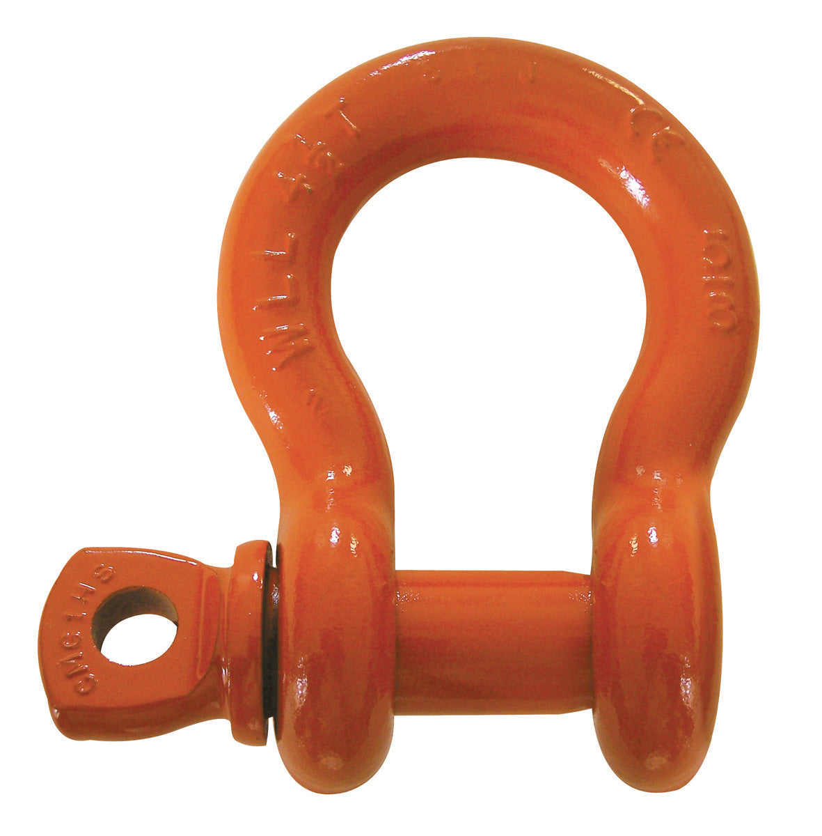

I have some of these screw pin shackles with a mark I'm unfamiliar with. The "M" inside of a circle.
I can't seem to find anything online - or can't search correctly. Does anyone know who the manufacturer of this shackle is?

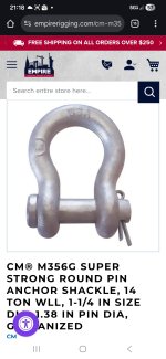

Not my area of expertise, but this chart indicates that the mfg name should be top center.. the M is a product identification code.
Can someone more knowing confirm?
OP, anything on the flip side?

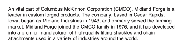

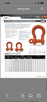

The M in an oval is Midland Forge, a part of CM (but maybe not an actively used brand anymore?).
From a business listing: "The CM Forge Group provides products to the commercial and government sectors. For government and military work, Midland Forge (CAGE code 90202) and Dixie Industries (CAGE code 93922) provide items primarily in Federal Supply Classes 3990 and 4030, as well as other FSC."
Catalog from 2008.
The WLL14t is a red herring as previously mentioned.

I do recall Midland Forge, but I didn't know they were part of CM. Thanks for all the replies!
