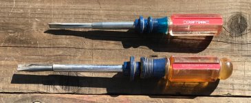

You slide the ferule down the shank to align the blade, insert in your screw, then slide the ferule back up and the blade misalignment will hold the screw.
16,702
Here are a couple of Craftsman screw holding screwdrivers. They can hold a slotted screw by putting the tips in the slot of the screw then pushing forward on the sleeve thereby exerting pressure on the outside of the slot. In some instances it really helps if the screw needs to go down a hole to start.

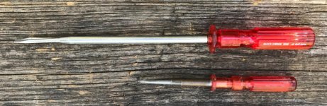

Here are a couple of Quick Wedge drivers I found at a Nevada garage sale in September.

16,702
Your thread got me started so I looked through my toolbox last night. My preferred screw starters are in the second picture although I’ve used both on many occasions.

Holding screwdrivers are something you don't use everyday but when you need them they are lifesavers, especially in tight conditions of places where you can't afford to drop a fastener. They are really useful for getting slotted screws started but were never intended to be used to torque down a screw. If you try to tighten a fastener down with a holding screw driver, you will bend and mess up the blade tips. Use the holding driver to get the screw or machine screw started (and make sure you are not cross-threaded), then go to town with a regular screw driver to finish the install.
