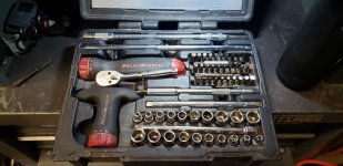

I've been using the old craftsman clear handles for years. I've bought 2 or 3 of the big sets. A few years ago I picked up a Gearwrench 56 PC ratcheting set and it covers all of my needs for torx and Allen bits, and there are sockets for nut runners.
I keep a couple extra things in the case, like a 1/4" hex to socket adapter and a 1/4" hex bit holder so I can easily throw the bits or sockets on my impact. And I also keep an extra 1/4" ratchet and 6" extension in there. This kits literally goes everywhere, on every job with me. To me, it's worth its weight in gold.
