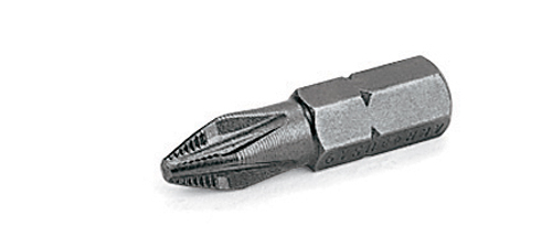

Recommendations: Slotted screwdrivers need to be hollow ground for best fit.
Phillips tips best fit would be the ACR style with the ribs.

The ACR type bits, IMO, do grip but also leave marks in hardware, which I hate on motorcycles

Agree on the hollow ground (also cabinet tip, PB Swiss are awesome slotted drivers), disagree on the ACR bits :beer:

Same here.
ACR bits were designed to have teeth that engaged matching teeth inside special ACR screws (which I have not seen in years, though admittedly, I haven't looked all that hard). When both came together, the screwdriver would lock into the screw as soon as torque was applied. But the ACR teeth really don't do much other than mar up the inside of regular Phillips screws.

Jesus, you must have eagle eyes if you can see marks on the inside of a Phillips recess. I prefer ACR but all it takes is a few uses without proper pressure applied and it slipping and I find they start to lose their effectiveness. One reason why I never lend out screwdrivers. Snap On makes both ACR screwdrivers and Diamond tips. Screwdrivers are one thing where the Snap On warranty is great. Depending on your driver, mine will swap out even if just worn. I did just order some Wera from Chads Toolbox. Great prices. Very interested in trying them out.

It's not quite that hard to see in the right circumstances. You're right in that on plain metal screws it's pretty invisible. But those marks can cause paint, coatings and plating to chip off screws. So, if you have chromed screws, or ceramic coated deck screws for example, you may end up with rust issues where the surface was damaged.

I agree that a well made Phillips screwdriver without the ACR feature will work fine on screws in great condition. Rust belt .... no such thing on a car older than a few years. I'm just generalizing.
