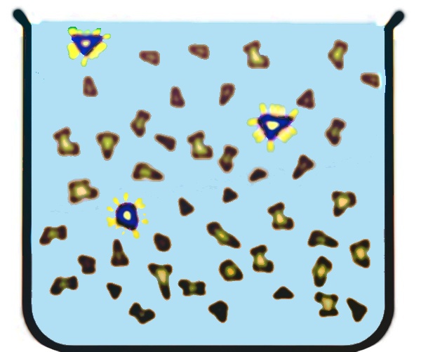

Dispersion:
Basically a dispersion is solid particles suspended in something. So, imagine if you took a bunch of Feta Cheese and suspended it in water. The way that acrylic is dispersed in water is with force that breaks the resin apart. Then, the particles have to be stabilized with some kind of surfactant. The problem with most dispersions is that the surfactant doesn't leave the film and surfactants are very sensitive to water. Basically, a surfactant is like a soap. When you do your laundy you are using a surfactant that will suspend the dirt from your clothes in water and then evacuate the dirt with the water when it drains. Typically, the particles in a dispersion are kinda jagged like the picture...

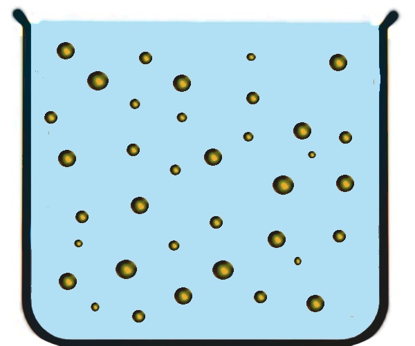

Emulsion:
Basically, imagine that you melt the cheese and then stir it into boiling water with a wisk. Then, you keep wisking the water/cheese constantly until the water cools enough for the cheese to harden in little droplets in the water. These particles are nice and round... easily filling pores...
One of the most important considerations is that the sealer you use is 100% acrylic. Adding other materials like Vinyl Acetate will cheapen the formulation and greatly lower the durability. Stay away from Co-Polymers... The other consideration is that the acrylic is really small...
So, if you have large open pores then larger particles of acrylic (most waterbornes) are just fine. But, if they are not as large or open then your best odds of longevity are really small particles that will pack into the pores.
