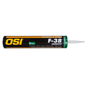

The best I have found for filling gaps in OSB is OSI brand drywall adhesive. It is color matched and believe it or not it really works. I used it in an unheated shed I finished for a guy about 3 years ago, no cracking yet.

Beware of the "ADHESIVES" (SUBFLOOR, DRYWALL, OSI/LIQUID NAILS. They are good but if you need to pull a panel good luck......there will be nothing left of it.
