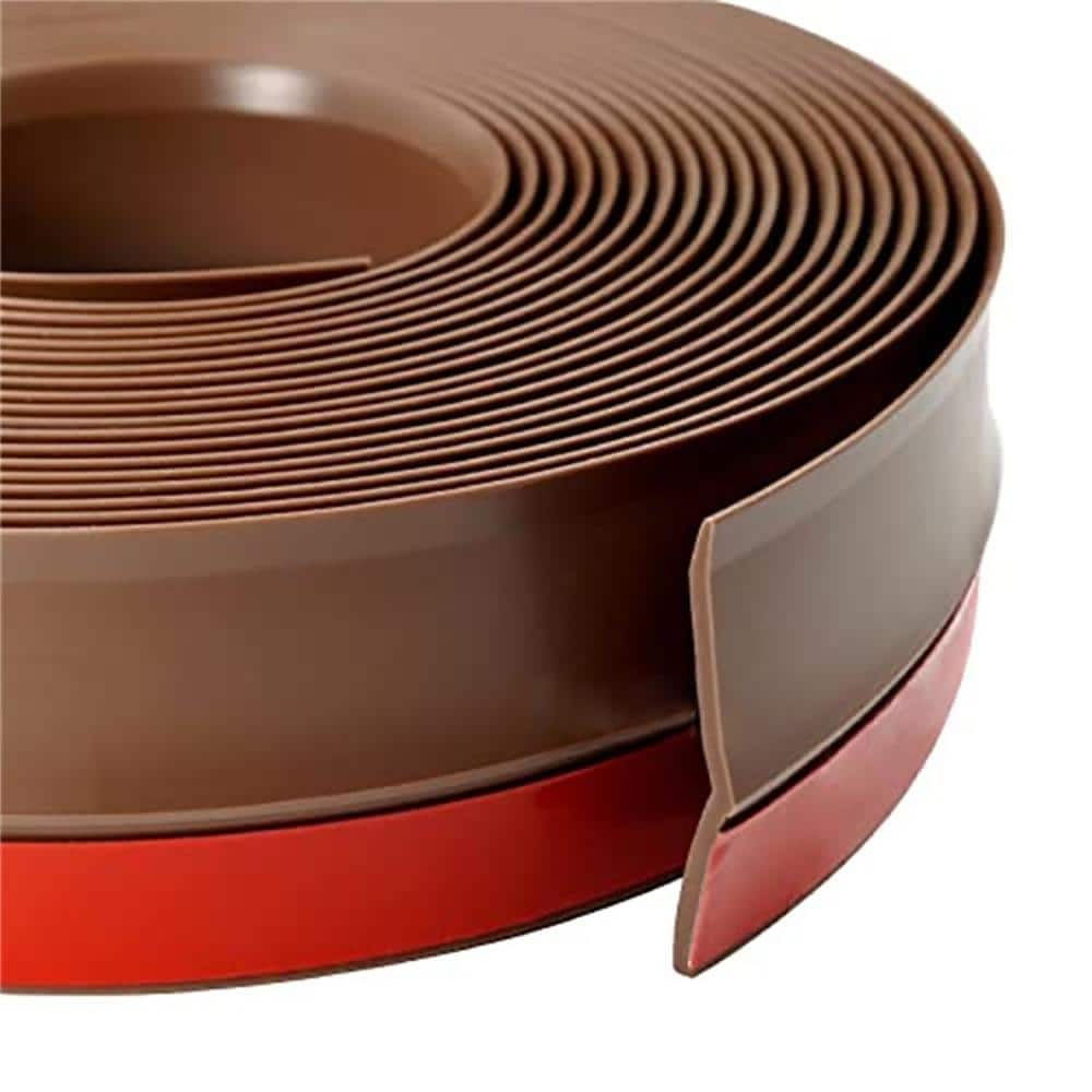

It is hard to tell the exact color on a monitor but maybe this would work?
Maybe visit some garage door sellers. Thinking there is usually more available than L and HD stock.
