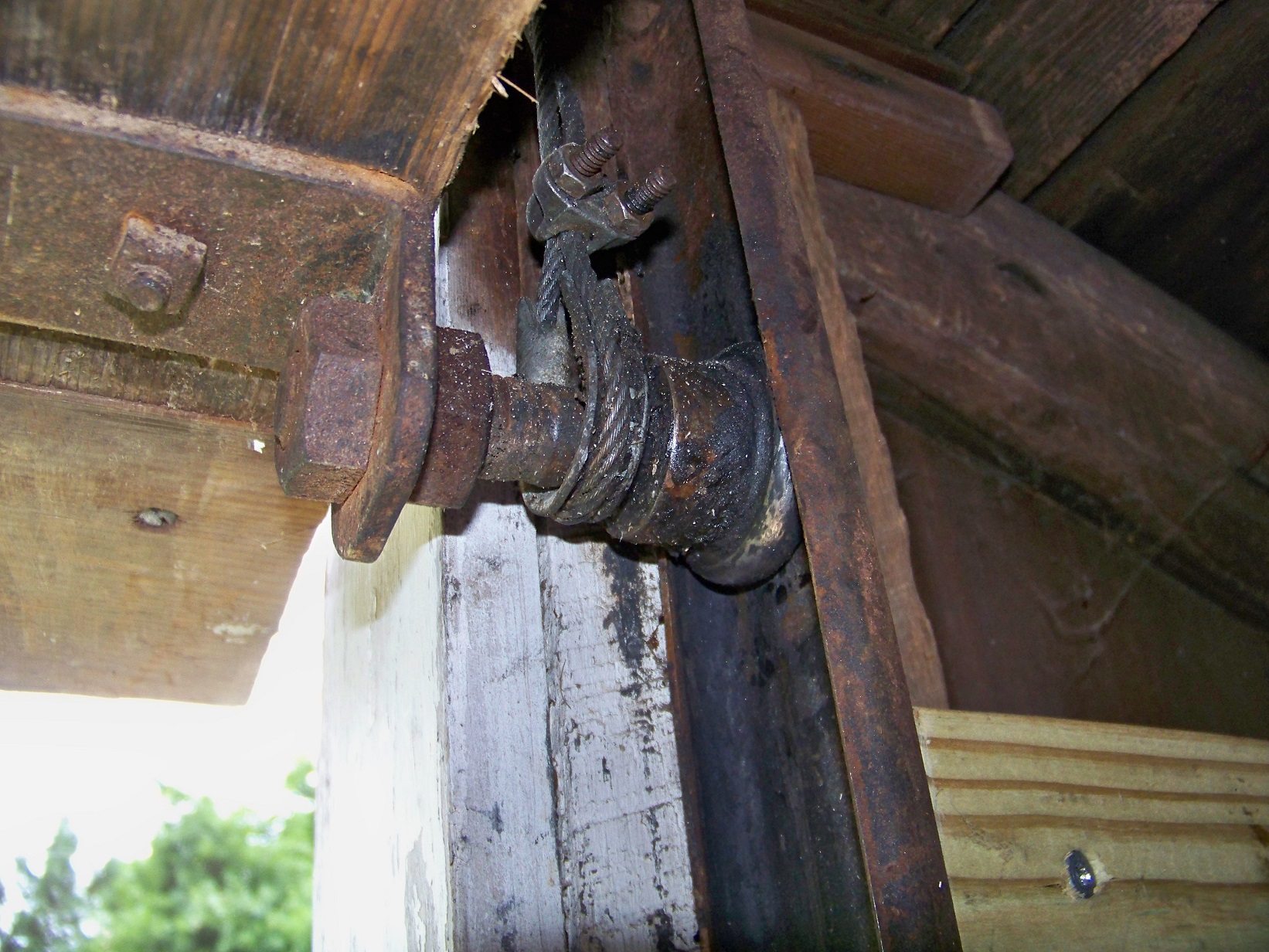

I'm searching for 80-something-year-old replacement rollers. Can't seem to find anything like it anywhere. They're 2 inch rollers with 3/4" threaded shaft.

That looks like an old style one piece door. Chances are you will have to create one. There are several companies out west still making one piece door hardware but I have not seen anything that beefy. You may be able fo source a bearing with correct internal dimensions and have a shop make you a shoe or whirl to press on the bearing. You only need 4 of those, correct?

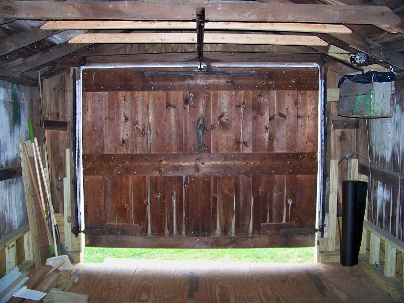

Yes, Single panel. Only need 2.
Image linked to larger view
I might bail on this quest and just install a new sectional that seals properly. I'm also not sure I have enough ceiling height to make a sectional work.

EatonEggbeater - Yeah, I spent a fair amount of time searching through McMaster Carr. Mounting a new bracket with standard shaft roller might work.

The advantage of things back then is that they were simple, and usually serviceable.
What's the issue with the track rollers you have? I'd be very surprised if a machine shop (or friendly machinist -- we have a few on here) couldn't fix or remake whatever's wrong with them.

  • Open door and block it to remove tension.
  • Screw door to blocks so it can't move when rollers are removed.
  • Remove, repair, replace lower rollers.
If I could buy new ones it could be done at the same time and the garage door wouldn't be open for an extended period. Now that I have a real floor, I actually care, but I can throw a tarp down to reduce rain damage.
I expect to discover that I need to replace the upper center hanging rollers too. That is a little more interesting as the door has to be closed so once I remove it I'll have to crawl out of the window. Awkward yes, but feasible. (I removed the - not original to the shed - side door during rehab as someone compromised the structure by cutting in a door right through a critical beam.)

looking at the pic I'm thinking that new style rollers could be used, with a 3/4" bolt drilled in the center to slip the roller in .
or separate the roller from it's shaft and a bolt machined to accept the roller

The Cobbler - I believe it's a standard 2" track roller (which I think is ~ 1 13/16"). I haven't put calipers on them for exact measurement. Just to clarify - you're suggesting a 3/4 bolt machined to accept a standard 2" track roller which requires a 7/16" shaft hole. I like it. Simple and effective. Even taking the minor thread diameter of the 3/4 bolt into consideration (~0.625) that leaves ~0.093 bolt wall thickness at thread area - which is certainly more than adequate.

why can't you cut a new roller and tap the end, double nut on both sides of your bracket it so it won't come loose. Worse case is you have to replace the tracks (which may not be a bad idea) if you want to keep with the antique theme use square nuts and spray with a rust color.

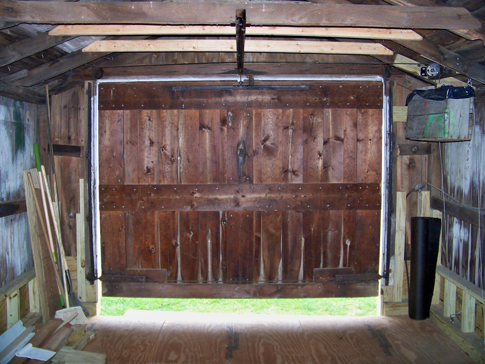

I don't understand how tin overlay can be used to create an adequate rodent barrier. It's a single panel door:
The original design had 2 vertical 1x4s with 2 obround slots (top and bottom). Carriage bolts through the door -wing nuts towards exterior and a knob in the center. Loosen the wing nuts - push 1x4 toward jam via center knob - then tighten wing nuts.
You can sort of see it in this pic
(linked to larger view):
