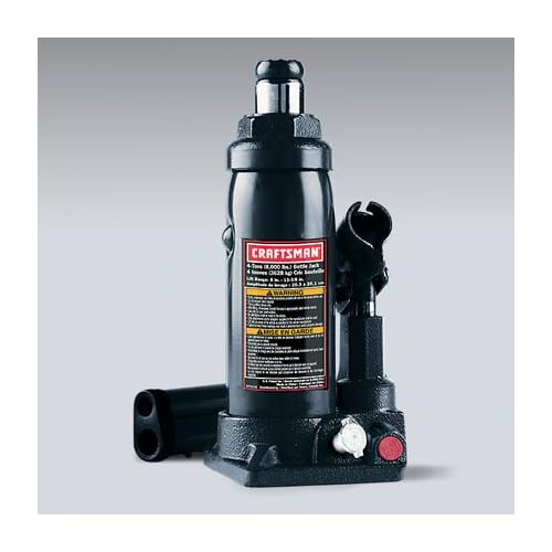

If you are talking like this:
With the fill plug/screw and another screw beside it, that should be screwed all the way in as it is the release.
If not, I still am not clear on what you are talking about. How about a picture?
Not to nit pick, but actually the fill plug screw can be seen on the left side of the bottle about half way up the side.
I think he is talking about a rather large looking plug on most floor jacks sold today that is located back on the square base of the block and sometimes is flush with the block, and other times protrudes above the surface of the block. In either case it is located in close proximity to the handle and the plunger rod that actually actuates the lifting arm up and down. The described screw and location is not any adjustment though, once the plug/screw is removed from the square base of the bottle all you would find is perhaps a spring and a couple of ball bearings or the like.
No, if that jack isn't lifting I still say it must be leaking and low on fluid, no adjustments are needed. Also fluid does not evaporate from jacks, it leaks, thus my saying it is leaking. They do not simply get low on fluid.
