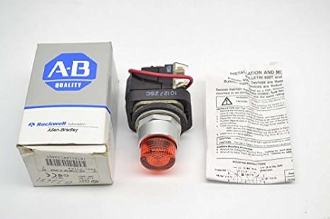

I know exactly what it is because I used one in the electric shop building electrical cabinets!
Imagine that...I actually know this one!
You see, it is a notcher for notching anti rotation notches in holes where switches are inserted into the holes.
First you would knock out a 1/2" or so hole in a metal door and then notch the upper part of the hole with this tool so the anti-rotation washer would lock into the hole....
Makes the notches in these holes....
It is actually called a Greenlee 720 Keyway Punch...makes perfectly square notches everytime!
For industrail switches in cabinets....
...and now you know! Uh, sorry to burst your thread so soon....

Interesting. You just insert the end of that into the hole and squeeze? Does it make all four notches in one go?
No, one at a time.
The box I was showing was pre-punched by Allen Bradley and punched on all 60 degrees so you can mount the box in any position. The notch is usually on the top.
