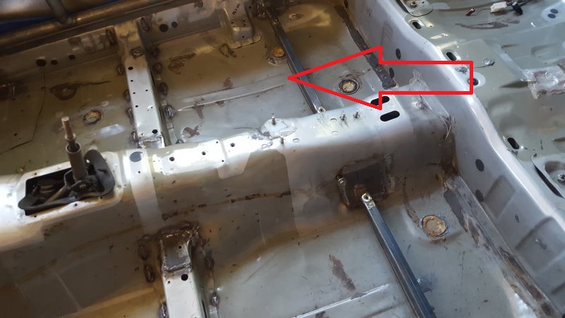

I need to fabricate some kind of a mount for my battery, and not sure what the best approach is here
There are two complications:
1. center of battery rests on the floor "hump"
2. I don't want to drill through the floor, meaning that the studs should be pointing up, so nuts go on top of the battery bracket
Also that floor metal is very thing
The car will have full interior/carpet
what would be the best approach here?

I'd run some 1 x 1/8" flat stock from the raised portion of the floor that the front factory seat mounts attach to back to the cross bar you added for the rear mounts to form a bottom strap. I'd weld nuts to the bottom side of those straps to bolt the top straps to.

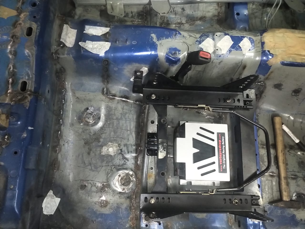

actually I am still on stock seat mounts, second pic is just for reference
I wanted to fabricate seat mounts like in my rally car, but this car will have full interior and putting carpet on top of these would be a pain

my concern is that I am welding to a very thin sheet metal (floor) and I am not sure it can withstand the acceleration/braking G-forces
at the same time I am trying to keep the mounts/battery as low as possible

I'd personally weld an overlay piece the same thickness as the "hump" on either side. I would incorporate 2 threaded studs to each overlay. The battery would have sufficient support from the bottom, the surface area of the mount would be more widely distributed on the sheet metal floor, and the hold down would be easily removed with 4 nuts.
I think this seems to be the best solution, I have 2mm thick steel that I could use for this
for threaded studs, because I only have 2mm of thickness to play with, I am thinking I could make threaded holes, screw the studs in 1mm and use weld it from underneath to make it flat, than weld those places on the floor
does this sound reasonable?
and to address the electrical comments, yes there will be an inline breaker switch (pictured) and I will also have a master cut-off swtich, I haven't decided whether it is best to cut positive or negative - the idea is to be able to kill the engine, and disconnect when storing the car over the winter so the battery doesn't drain

I wouldn't bother threading the holes, just weld the studs on. If you look at some of the sheet metal battery boxes (very common in off road) that Bodj linked to, you will see that they are fairly thin sheet metal and are very durable. We run dual Odyssey batteries that appear to be the same size as yours using one of these mounts. The batteries themselves are rather lightweight, so it doesn't take much to hold them securely.
