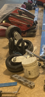

I started welding the main frame yesterday and got the wheel supports tacked into place. Slight change of plans on the uprights. I was going to make all three uprights 31" tall off the deck. Now I'm thinking staggered heights to accommodate shorter (all ready cut) sheetgoods. Maybe 18",24" 31" tall uprights.
I got all the metal (12 gauge 1 1/2" square tube) and wheels for free from a TV production a couple of years ago. They had two chandelier transport carts they wanted to get rid of. I spent a few hours cutting it all up with a grinder. There's no way I would have built this if I didn't get the metal/wheels for free. It's amazing how quickly material disappears when building something.
Pic of the frame and the wheels below.
