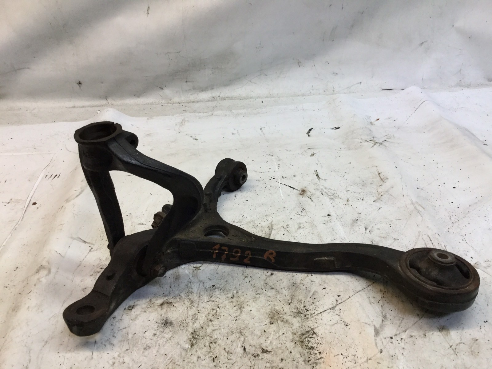

I needed to do the struts on my Honda Accord. The strut fork bushing bolt is seized solid inside the bushing metal sleeve. The nut was easily removed.
The bolt is supposed to slide out with a tap. I have tried a 3lb hammer, tried to spin it with impact gun, and even hooked a C-clamp ball joint press and cranked it with a 24in break bar. There is absolute no movement from the bolt.
Luckily, I was able to remove other bolts easily. Basically, I can take the whole assembly off, like in the following picture (from an ebay seller):
If I do this, I need to cut the bolt to free the fork, and then replace the bushing and bolt. There is at least 1/4" of space between the fort and the control arm, which seems a good candidate for some kind of saw.
What do you think is the best to cut the bolt? Sawzall or grinder? Can a manual hacksaw work? The bolt is 10mm in diameter.
Thanks for you help!

Yes, it's on the lower control arm, holding the strut fork.
The problem is not the rubber, which can be burned or drilled away. It's the metal tube inside the bushing that prevents the bolt from being removed, so that I can remove the fork.
I know the bushing and the bolt are trash. Here is the new bushing I already have. The bushing is two big/small metal tubes with rubber in between. The bolt was seized in there like the 2nd picture. I was thinking of cutting the stickied out part of the bushing, which is 3 layers:
rubber, metal tube, bolt.
From the sized of the gap and surrounding metal, the saw blade can't be too short. If it's a grinder, the wheel has be to thin enough and large enough to reach there, I want to at least save the fork.

I just did exactly that, but I made the cuts on each side of the bushing, yoke and arm were not harmed. With the car only on jack stands, I had to remove a lots of parts in order to be able to cut it. Here is the offending bushing/bolt:
The tools used were:
Milwaukee 2719 Hackzall
Plus Diablo Carbide blade
Regular blades are no good for the grade 10.9 bolt.
