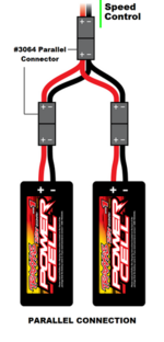

I purchased two of these battery to run a motor, I would like to select the second one after it is depleted.
Can I use the switch in the second picture?
set up question, Is it safe to tie the negative of both batteries together?
There is a pigtail for charging on each so I will be charging both of them separately to full charge. But I am not sure if tying the negatives will cause any problems.
With the 1+2 switch, would this be a problem to switch to that setting, I think this is letting both battery work in parallel, if one battery is higher charge it should slow equalize. If doing this is too much problem I will get a switch that only has the 1 and 2 (without the 1+2)

tying the negatives together will not cause issues.
that switch is designed to use either battery 1, or battery 2 , or both 1& 2 simultaneous ( in parallel)
I would not switch it to 1&2 when the 2 batteries are at different voltages. at least not make a habit of it.

What I do not see in your photo scares me! That is, I do not see any fuses.
In the event of a short circuit, you must have fuse that will blow before so much current flows that the batteries explode or a wire gets red hot and starts a fire.
Ideally the fuse would be inside the battery or the first thing that connects to the battery.
Putting the batteries in parallel is risky. If one has more charge than the other it will try to recharge the weaker one and maybe so quickly that the battery get damaged.
Understand big lithium battery are not a joke they are a huge source of potential energy and treated with the same respect you would afford an equally sized container of gasoline.

Is this Lipo or LiFe04? The latter doesn't have the fire hazard risk that is associated with "lithium". If they are not over-current protected, then yea, they can usually provide more power than a wire can take.
We run LiPo batteries in parallel all the time in the RC car/airplane/helicopter space... It's a pretty normal thing. But we disconnect 'em (a switch would be fine) when done.
Those are "T-plug" connection types, you can buy pre-made splitters and save yourself some solder hassle. Make sure you get some with the correct wire gauge.
The "overall" issue you will have eventually is "battery balance". If you charge them in parallel long term they will tend to get out of sync. To solve for this, you simple charge them individually every once in a while, so charging up stream of your A/B switch is fine.
