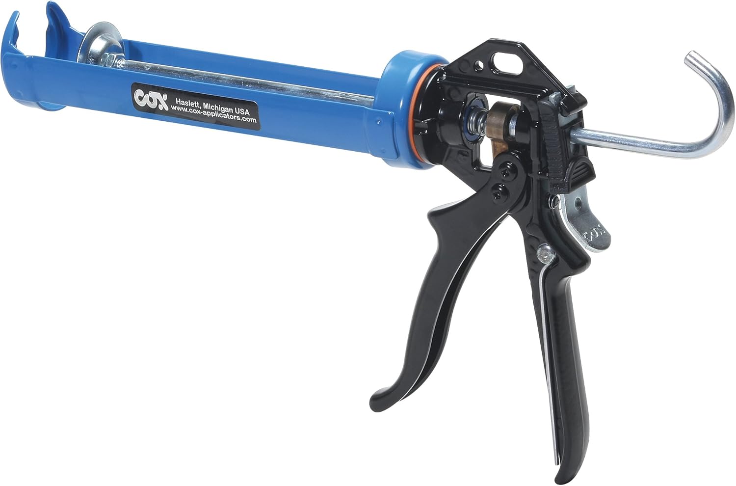

I prefer Cox guns because of how rigid and smooth operating they are. Raise your hand if you've ever used a cheap caulk gun that bends and flexes as you pull the trigger? And that creeking sound it makes when it flexes? Not so with Cox. A totally different experience. Cox guns are rebuildable too with an availability of parts.
