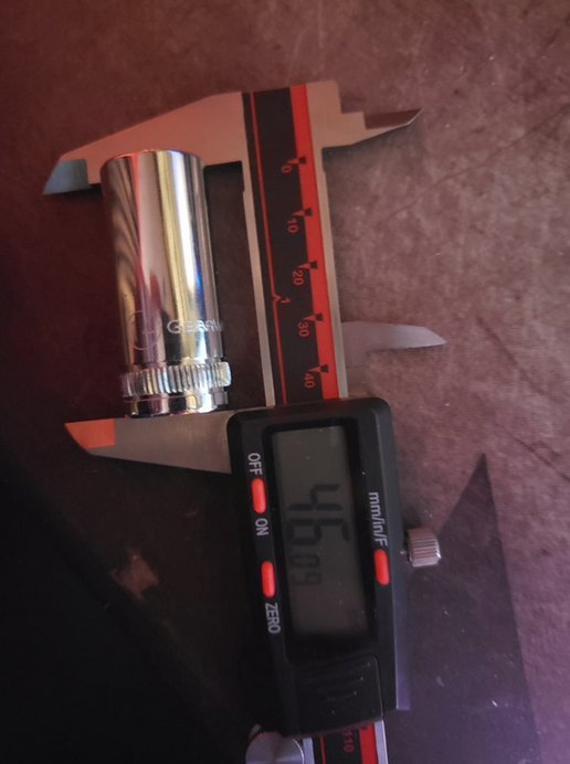

Trying to find info on the actual depth of the broach on Gearwrench semi-deep in 3/8" drive. Anyone know where to find measurements on the net? The GW site does not have that measurement , pretty much everything but. Or maybe someone could measure a socket? Say a 9/16"

Actually Gearwrench has the information on their site. You just have to open the catalog up, scroll to page 135, whee you'll find a breakdown on sae mid length socket demensions. I t looks like the 9/16 socket is 1.81 inches long overall with the broach being .83 inch deep. :dunno:

I've only got 3/8" semi deeps in metric, but could happily do 1/4" ones in SAE or metric if you're interested. A comparable 14mm socket measures 46mm tall and the broach is about 22mm down from the top/outer lip of the socket.

Thanks for the pictures and measurements.
Aaah, yes, OK. It is there. That's what I looked at before, but for some reason the generic drawing shape and the term "wrench depth" was making me think it was a different measurement.
