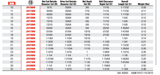

Does anyone know who makes semi-deep or mid-length 1/2 drive chrome metric sockets? If you could please list brand and part number please.
I know Genius makes impact ones, but I'm looking for chrome ones. Thanks.

Edit. I took some screenshots from Proto's catalog showing the length specs for standard, intermediate, and deep sockets so you can compare the lengths and see if the intermediate sockets are what you are after.
Are these screenshots taken from a newer Proto catalog? The pdf catalog I have doesn't include these part numbers. I see them on their website, but the website leaves a lot to be desired. I guess I'm off to search for a newer catalog...
The screen shots are from what should be the newest Proto catalog. On the Proto main page go to the support tab and click "catalog" from the drop down menu. I agree on the Proto website being bad and looking through the catalog I see at least one thing that is still out of date. The web catalog shows the handled pry bars as having a clear yellow handle. For a little while now (maybe a year?) when I purchase new they instead have a grey/black striking cap handle similar to Mac pry bars. An upgrade to be sure, but it annoys me that they haven't updated that fact.
