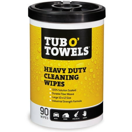

Home septic laundry is more of a concern than hand washing. Functioning modern system should have no trouble with either one.
That said I use these and thrown then in the trash
