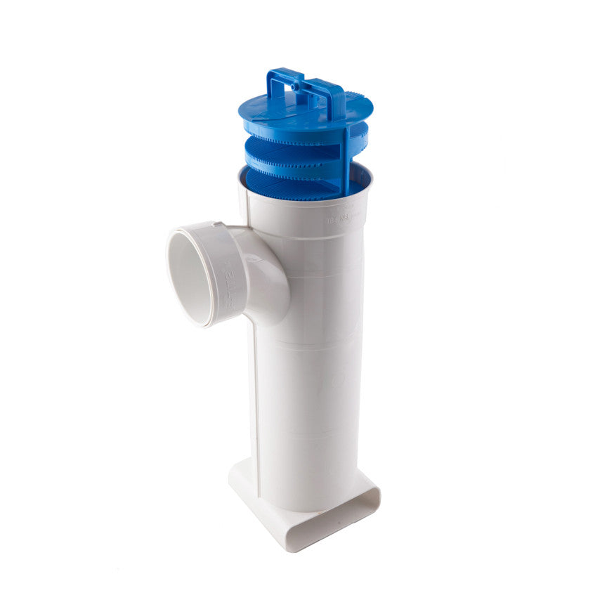

Is there one filter that is better than the others?
Just rent a mini excavator or tractor loader backhoe and do it yourself. For failing concrete tanks the backhoe/excavator bucket is used to break up the concrete. This concrete can either be left in the hole, or removed.
A new poly tank weighs less than 1,000 lbs and can easily be moved into place with the backhoe/excavator arm and a strap.

I don't need a replacement tank, just thinking that adding the filter would be advisable. I am not even certain if it can be added to a 40 year old system. That was the purpose of my asking.
djbmw
Jun 20, 2013
1,248
Ottawa, Ontario, Canada
Got it. Yes, they can be added on BUT, why would you? If the system is 40 yrs. old and working well - dont mess with it.
My tank is also 40 yrs old (concrete). I too had thoughts about adding a filter but figured there's really no need. The next 'upgrade' it will get is a replacement tank (with poly) ... but that will only happen when the tank fails.

Wait..There's a filter? That sounds smart. Pretty sure mine is just two tanks, gravity, a drain field and some water/poop.
I get it if there is a sprayer system for the yard.
I've heard of pump filters on pump-based septic... But I went way out of my way NOT to install something with a pump this time around.
Yes, a filter. It keeps the expensive to replace leach field clear of anything that shouldn't go there. Cheap, effective and easy to maintain. Pop lid, pull filter, hose off, replace. If you don't have one, get one.
