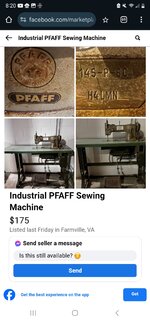

I'm not good with Facebook but using my wife's account I don't see it listed anymore assuming it sold quickly at that price. I'm 7 hrs away and would have jumped on that if it was running.

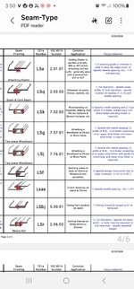

Seam Type LS (alpha) K-2
Stitch Type 301 or 401
Indy: Most of the bags and straps are for holding or securing specific equipment. One example is a loose items bag that is a rectangular block, with a 3 sided top that covers a portion of the bag, and has a number of DOT "Lift the DOT" sockets and studs. All the materials originally were either 8 ounce duck canvas or .030" or .050" thick cotton webbing. Finding the correct materials is a bit of a challenge.

also requires doing some translating to convert WW2 standard call outs to something that is understandable to a sewer to day. Haven't found enough data to do the translating yet. Here's one on the drawing:
you need a copy of federal standard 751, which defines what all this is (with diagrams, for a lot of it.). the WWII era version should be readily available online (I have a printed version from the 60s, somewhere. I rather doubt the WWII edition would be much different.). At some point the FS751 got replaced by an ASTM standard, which I don't know the number of. it's still in use to specify how to sew stuff up, because there are lots of ways to do it, with various tradeoffs in required equipment, seam bulk, seam strength, material used, and so on. There's also an iso standard which specifies the same stuff, but uses an entirely different way of naming and calling out details.
an LS type seam is a lapped seam, the various sub classes tell you how to deal with the edges (what gets folded under what, before or after the initial seam, and whether it's sewn again. ) stitch type 301 is a single needle lockstitch, 401 is double chainstitch.
