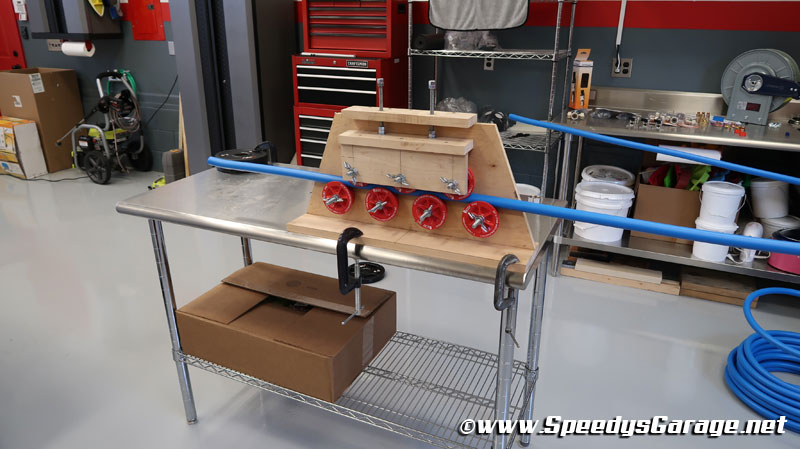

Pipe straightening jig was well worth the money. I got it from a gent on this forum after he completed his install. If someone needs it for theirs shoot me a PM.

Could you possibly show more pics of the line straightening jig? I may have to build one.
I have the 3/4" maxline in a box wondering how I'm going to make the install look 'reasonably' decent given the coil memory. Yours looks very nice.

The jig makes the job a piece of cake. I honestly wouldn't wanna do it without one. I believe Rapid Air posted plans for how to build it on their site. I would recommend you get a buddy to come over and help as well. Keeps the kinks out having two people wrestle with the roll of pipe.

How much effort does it take to pull the tube through the straightener? If you still have it I'm interested in buying from you.

Very little effort to pull it through, actually. You will need a friend or some jig to hold all the pipe though.
I've just about decided to keep the straightener for future projects. If I decide to sell it I'll shoot you a PM.
