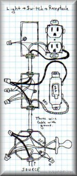

Found a picture that is similar to what I am talking about. The only difference is my source comes into the switch, so the 12/3 is between the switch and outlet, then 12/2 runs from the outlet to the light socket.

This is not a MWBC, it is a 3 wire conductor being used for a switch loop.
I am aware that it is not a MWBC. Thats why I introduced it (a few posts up) as a situation where the neutral carries the sum of the two conductors in the 12/3 wire, not the difference as a MWBC does.

There is no sum of the two hots if being split from the same circuit when coming from one breaker. If the two hots are being fed from two different breakers from the same side of the buss then you would have a problem of over loading the neutral. Sorry, but I’m a little lost with what point you’re trying to make with using the 12/3 in your example.
Edit: What I'm trying to say is the neutral is not a shared neutral in your example.
