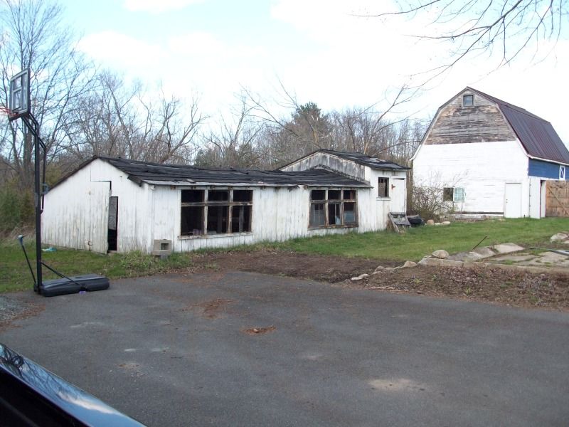

Need to tear down the old shed (former chicken coop) and I need a good idea how to do it quickly. I was considering wrapping a chain around it to pull it down, but a better idea would be appreciated.
It is destined to the burn pile.

I am at work so I can't see the coop pic. But how about a sawzall? lots of fun and you can take out your frustrations too.

If it's frame construction, a chain will probably just pull the shed off of it's foundation, in one piece. Sawzall is the ticket, if you are not going to salvage the lumber.

Sawzall and a GOOD demolishion blade. It will probably take a couple blades but get the good ones, not the cheap ****. Run a cut around the shed by the top and pull the roof down and cut into pieces. Then cut the walls down and into pieces. I wouldn't use a chainsaw, to many risks involves.
I took a metal one similar to that down this spring using a sawzall and a metal cutting blade on a skill saw.

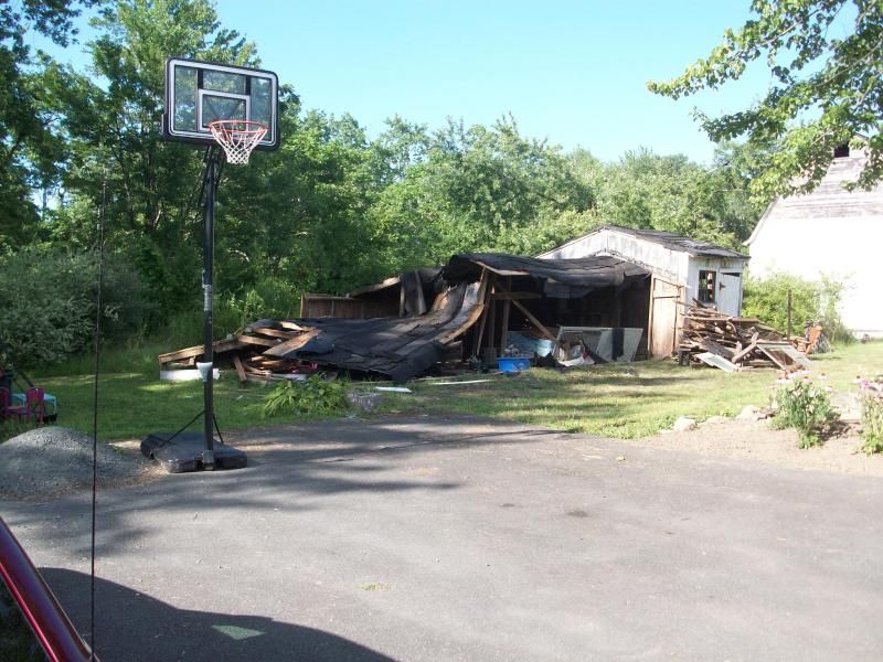

Something like that I would make quick work of with a Milwaukee sawzall w/quality demo blade, a sledge hammer, and a prybar. It would be leveled and gone in no time flat.
I have been cleaning out and tearing down sheds like this one on my property since '99. This is the last one, and I just started taking it down this morning.

Some heavy gloves & a short 4X4 post (4') will beat the living daylights out of the roof sheathing, & the rest will come apart pretty easily, another note is it may be better to strip the shingles off the roof first & you will be amazed on how quick the plywood roof sheathing pops off the rafters.

I second the sazall with a demo blade idea.
I fish the blade into the cracks to cut all the nails possible.
With all the nails cut you can just push it over.
That gets the roof down to ground level so you get the shingles off.
Shingles are usually a burning no no because of the heavy smoke so I just sneak them into the trash over a few weeks time.

This is the best way to do it. There are quite a few folks out there that could use a halfway decent shed. Toss it up on CL and it will probably be gone tomorrow :thumbup:

If I was near, I would carefuly take it apart and reuse the lumber or sell it. Its a waste to distroy it. Or sell the hole building. Looks good to me. you can reuse everything except the shingles.
