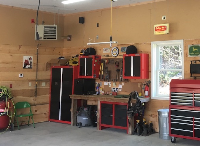

I used 5/8" BCX sanded pine ext ply on a similar sized garage up to 8" height. 1x10 pine up higher. Primed, 2 finish coats, screwed, cutout for elec boxes, R 15. it works, looks good and is removable.
If you are looking for rough sawn pine 1x10 , check with Kevin Down over at John Brady Sheds in Newfoundland, NJ 201-327-4089. He's always got it in stock.
Skiff Builder

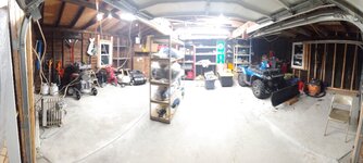

Thanks for the help thus far. Finally got some stuff back inside, noting really organized as of yet but nice to be back in my space87f58cc9740de4bf5d5409abb3a406c3.jpg064e39bc645636fee6c1b174613235f0.jpg
