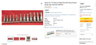

Here’s a couple screenshots. Interesting to see the huge difference in price between the Bluepoint and the Snapon T60. Seems like less markup on the Bluepoint Import stuff. $270 for 13 bit sockets, made domestically, with comprehensive warranty is arguably “worth it”. Still a lot of money, though.

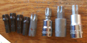

okay... you made me to dig 'em out and look.
looks like the one marked "USA" is the only one that's been used - second from right.
so... THAT ONE would have been the lone survivor on the first removal of the bed on the Ranger.
when we bolted it back down, I hosed all six bolts with anti-seize after cleaning them up on a wire wheel, so they all came out easy (with the same no-name "USA" bit) when we had to replace the fuel pump less than a year later.
Sorry I can't tell you brand on it... it's only marked "USA" and "T55"
For reasons I probably don't need to articulate, I'd steer clear of the "Husky" - it looks sketchy right out of the box with that "tapered end" action going on there.
not sure where I found the plain black bit inserts. none have seen any use.
