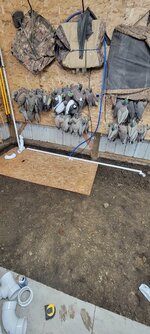

Im getting ready for my shop bathroom. This is how I planned on running the plumbing other then the vent off the sink to the stink pipe. The toilet and sink will be within a few feet of each other. Also is it a good idea to add a clean out on the exterior of the shed before a septic tank. The tank will be set within 10ft of the shed. Screenshot_20250711_152547_Samsung Internet.jpg

That said one vent for both (or all three) fixtures is all that's needed. What you posted originally will work just fine. Make it easy on yourself and do whatever you want. There're 37 ways to skin a cat.

Bear with me? Not good withball thebfsncy pictured but this is how im thinking i want to run everything. Toilet on the left. Straight out and 45 to septic tank. Stink pipe inside the wall to the attic. 1.5 San tee just above the 3in back to bathroom sink and another san tee? Past that to another sinking the outside of the bathroom. Sink drains inside the wall. Cleanout will be outside shed before tank 20250716_205943.jpg

Not a plumber. I think your horizontal toilet pipe should connect to the vertical stack with a sanitary tee, not a straight tee. How do you access the clean out at the base of the vertical stack? Putting a bi-directional clean out just outside like Sumboodie said above might be better.

I edited after your post. I forgot to add there will be atleast one clean out before the tank.. more the likely right on the outside of the shed sweeping back to shed. Tank will be approximately 6ft from shed

So now I plan on running my drain line in the wall cavity. Im thinking if doing 2 layers of 2in foam board at r10 a piece then 3.5 insulation within will my packed down a bit due to having 6.5in posts. Any issues any one sees with this?
