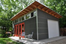

Well, I received a bid concrete that surprised me. We also need our driveway extended (15'x25') along with the 20'x20' shop floor. Bid came in at $5700 for all of it, including a course of block for the shop. Very reputable company owned by a guy who lives in the neighborhood. So it looks like it will be concrete floor after all.
Now to finish the plan for the shop. Build will be similar to the pictures below. Without the garage doors in my case:
