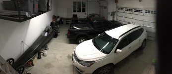

i agree, I changed my shop layout a bunch from this original design. I think its 34x28x13 so similar. I use the 3rd bay for my shop. have dragster also I have in there. welding table/welder/toolboxs/ everything possible on wheels. I have rearranged it 5 times since moving in 3 months ago. I think its finally getting good where everything makes "sense" where its at and functionally things are where they should be. I move my welding table out into the middle as an island which works really well as a work space more than up against the wall, then just push it back.....

heres kinda what it looks like from my scaffolding. I have changed it from the layout since I wanted to push the dragster up against the wall behind the cars.....
